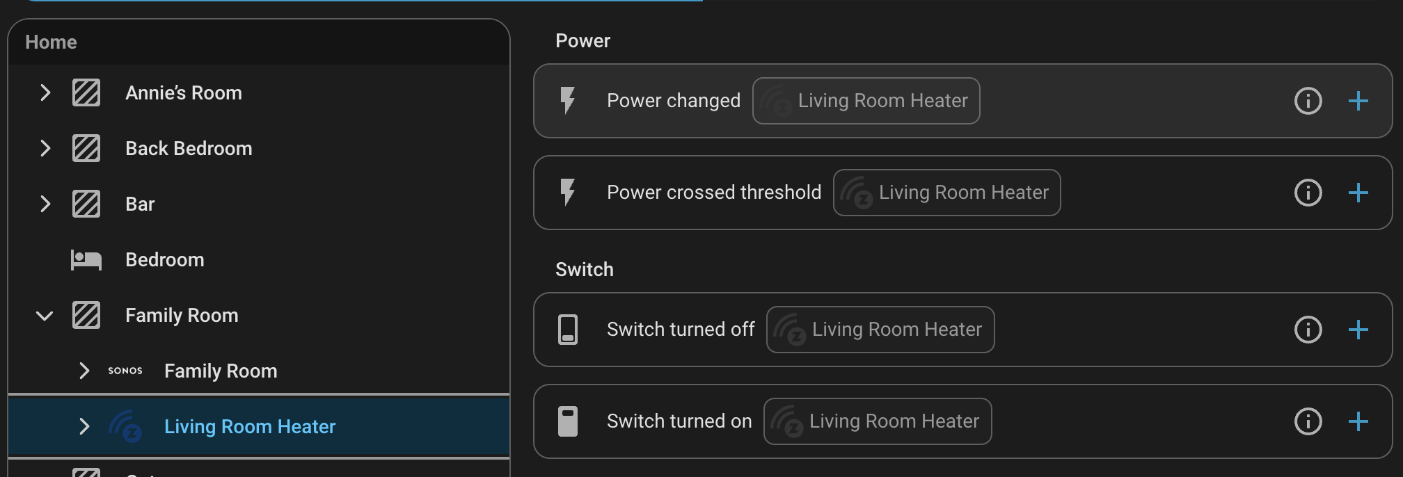

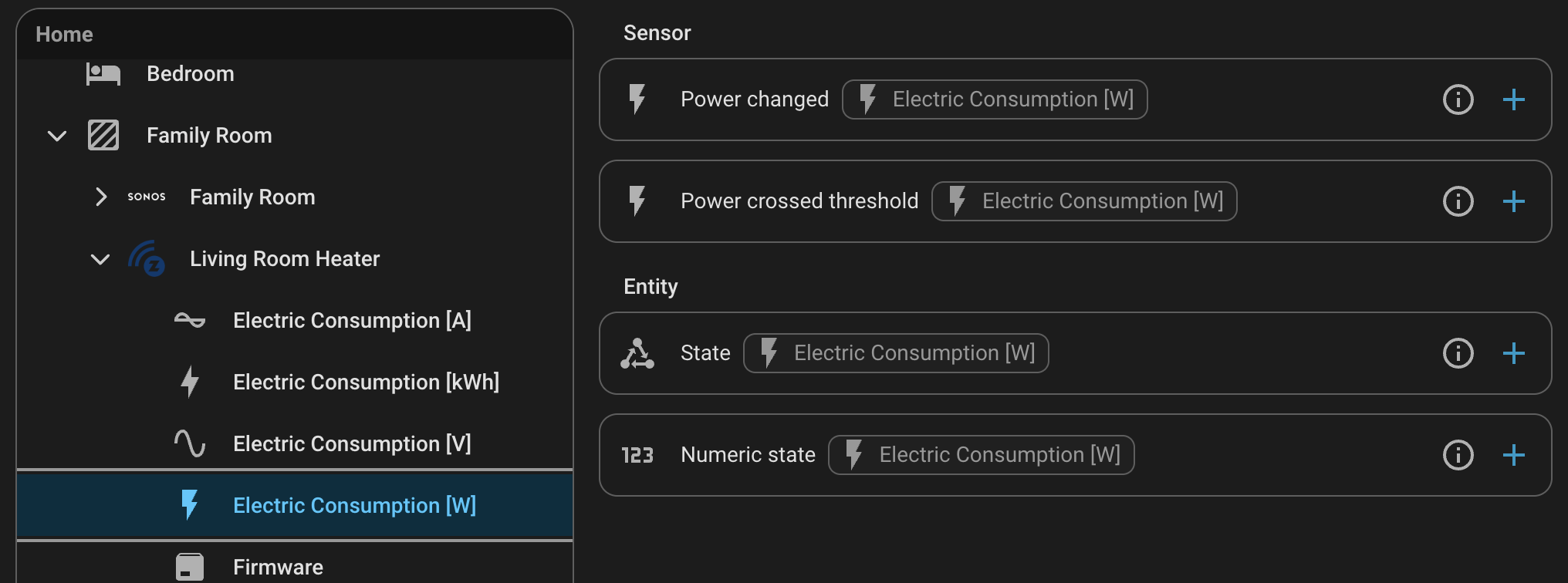

Regarding the purpose triggers.
Add Trigger -> Family Room -> Living Room Heater (opps on the name) then click Power Changed
and select above I get this YAML:
triggers:
  - trigger: power.changed
      entity_id: sensor.test_zen_17_electric_consumption_w
    options:
      threshold:
        type: above
        value:
          active_choice: number
          unit_of_measurement: W
          number: 1500
conditions: []

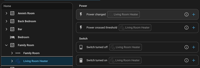

But, if I don't expand the heater and instead just click on the heater:
triggers:
      device_id: f9132b77802fdd11ea39afebd55d1b3b
    options:
      threshold:
        type: above
        value:
          number: 1500
Is that expected that one used the device ID or is that a bug? And if expected, what is the difference and why?

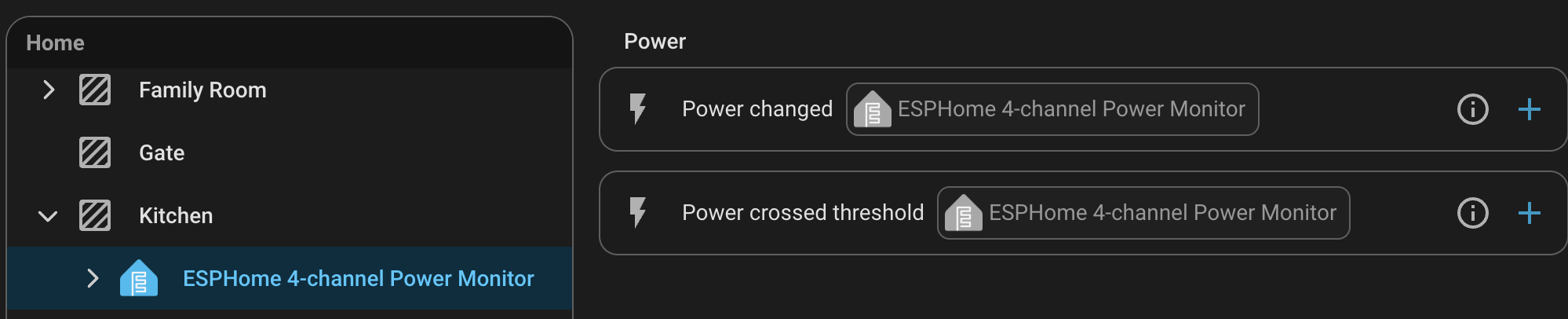

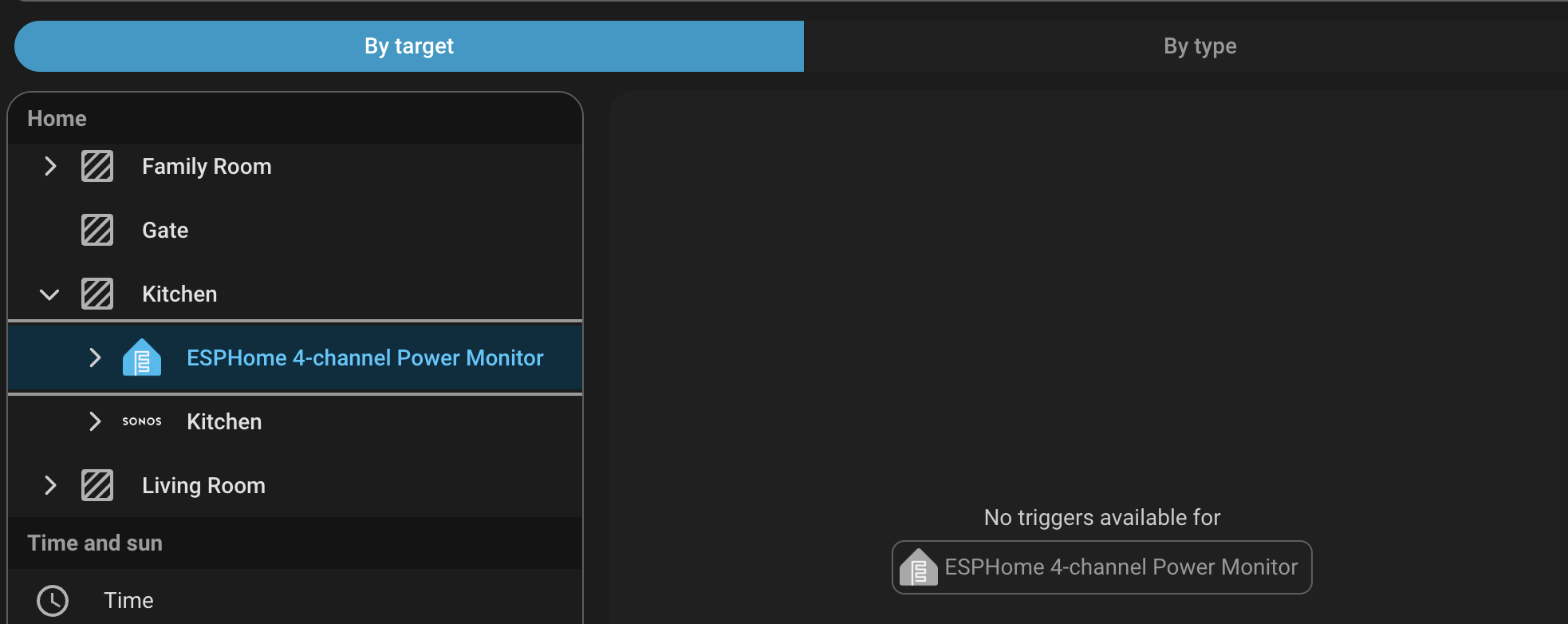

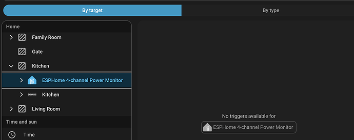

I have an ESPHome device with two power meters, but in that case I get this:
Is that expected to not have any triggers available? Is that something specific to ESPHome or a ESPHome YAML config issue?
That's normal. You're choosing the entity in the first screenshot, and the device in the second. The target yaml option works the same way as it has with actions. Meaning it can target devices or individual entities.

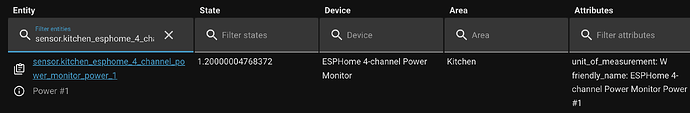

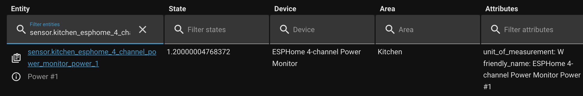

what entities reside in that device? Are they properly created entities? I.e. do they have device_classes, unit of measurements, etc.
 - platform: template
    lambda: |-
      return 1.2;
    update_interval: 10s
    unit_of_measurement: Ws
    device_class: power
What is it that tells the UI that there would be a trigger available?
Under the hood don't both trigger on an entity?
There's alot that goes into that and I don't know the specifics.
Yes, but from the device it has to find the entity based on the trigger type and if you have multiple entities that it finds, you'll get multiple things that are triggering it. Just like if you target a device in a switch.turn_on action and it has 2 switches, both switches will turn on.
Ugh, this esphome change caught me when changes are not saved on install! The device_class wasn't picked up, so now it shows (as you inferred).

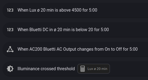

The Headline/Name of the entity triggers contain way more information then the new triggers (the last one). No numbers or times there.
