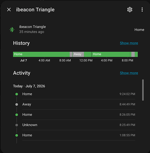

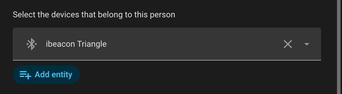

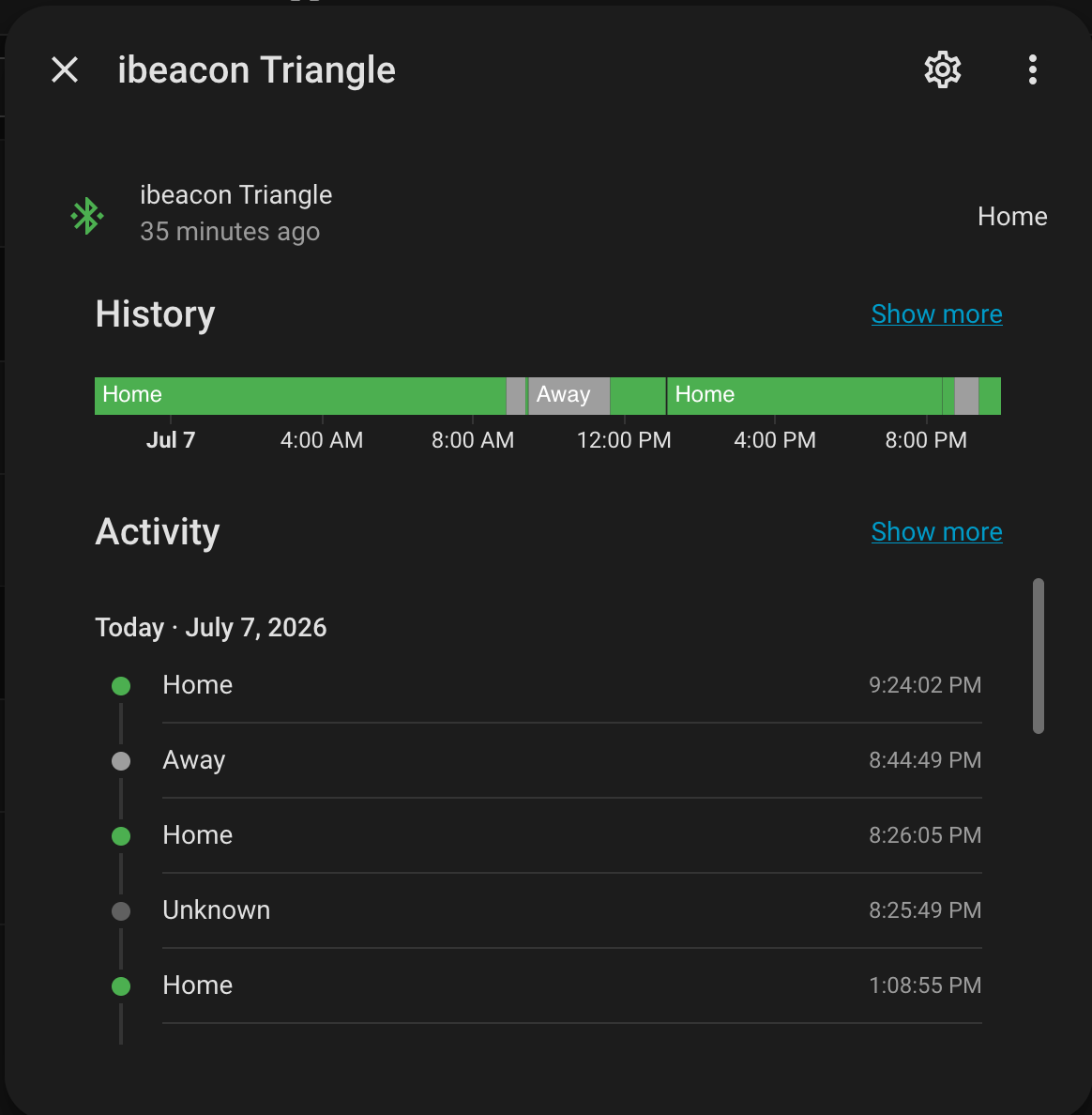

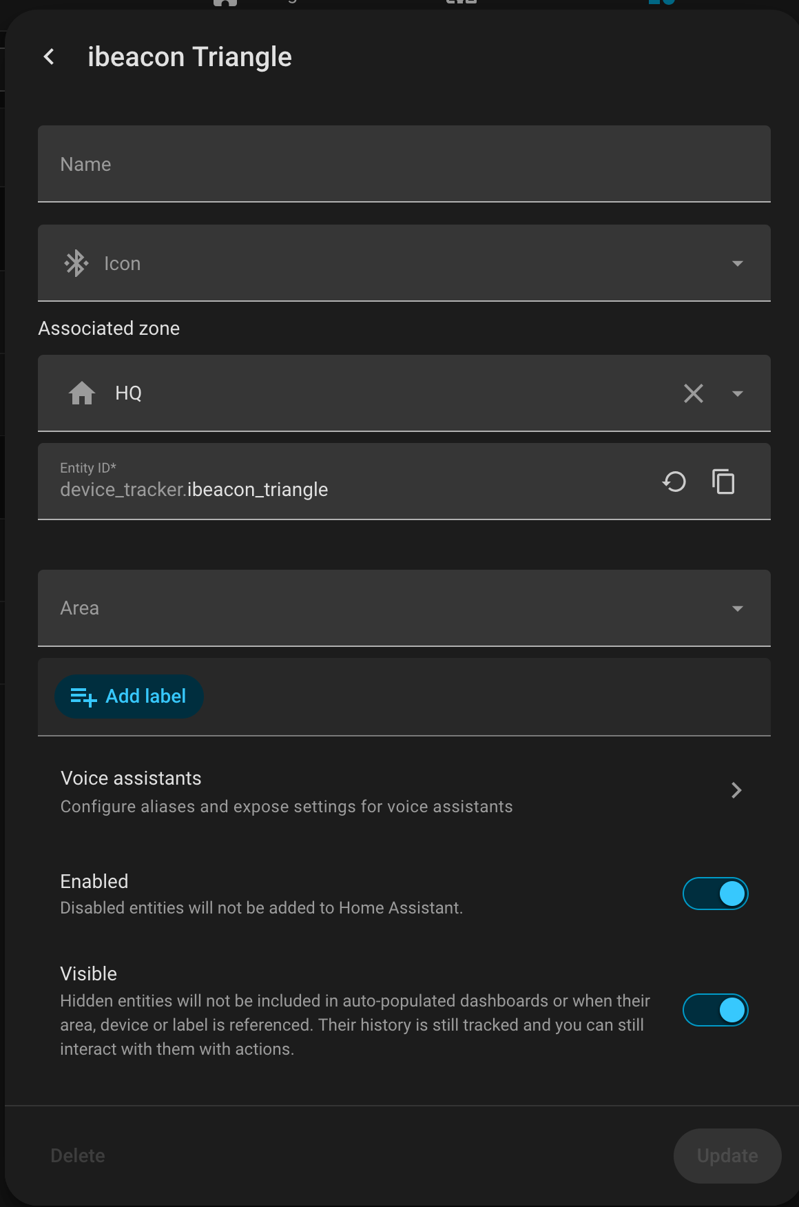

I use espresense and an ibeacon, as the only device tracker for my person entity.
In automations, I use the if zone.home > 0 condition - but since 2026.7, this is broken because my device tracker is no longer showing up in the correct zone.

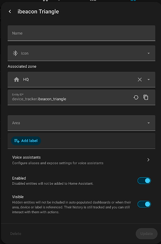

My person shows as home, the device tracker shows as home, but neither have the zone set, even though the device tracker has the associated zone.
Am I missing something?

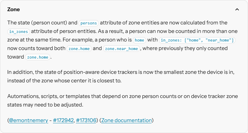

Release notes say this: https://www.home-assistant.io/blog/2026/07/01/release-20267/#backward-incompatible-changes

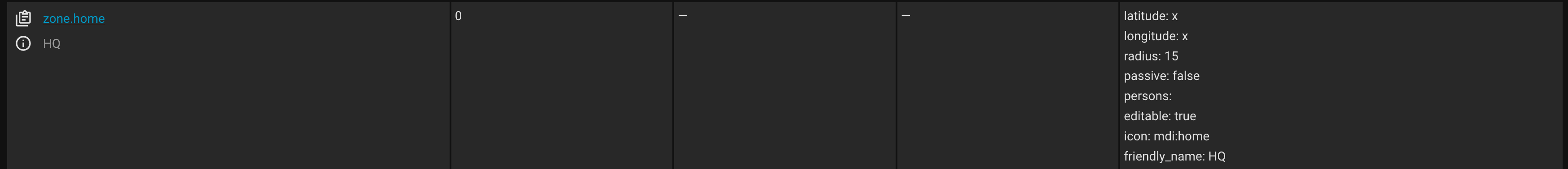

That sounds related. However, my Home zone should still count all persons which are inside the zone, right? I only got the default home zone.

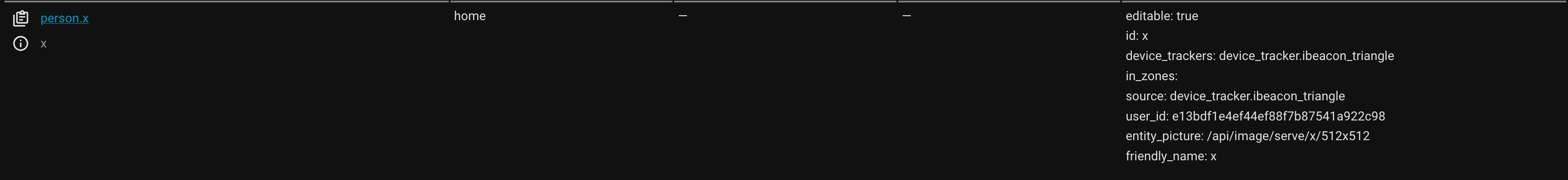

Only if the in_zones attribute of your person is being updated by the tracker(s).
You can check this in Developer Tools → States.
Yeah doesnt look like it. So downgrade Home Assistant to 2026.6 and wait for the trackers to be fixed or is there a workaround?
Can you use MQTT Explorer to investigate what json attributes are being published by ESPresense?
If it has an in_zones attribute than all you need to do is update your mqtt device tracker to obtain that attribute.
If it does not then ESPresense needs to be updated. Until then you could use a Template device tracker to update the in_zones template option from the mqtt room data.

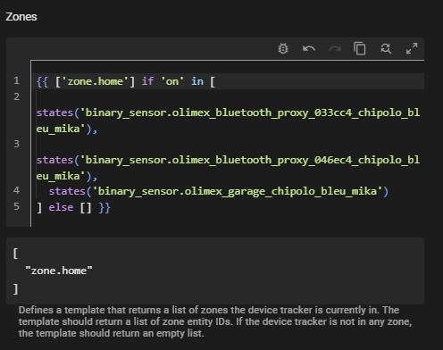

Hello everyone,
I’m also having issues with my setup. I’m using Chipolo Bluetooth tags, which are detected by my Olimex boards in proxy mode.
So I created my device_tracker helper like this:
{{ ['zone.home'] if 'on' in [
  states('binary_sensor.olimex_bluetooth_proxy_033cc4_invit_chipolo_2'),
  states('binary_sensor.olimex_bluetooth_proxy_046ec4_invit_chipolo_2'),
  states('binary_sensor.olimex_garage_invit_chipolo')
] else [] }}
But even though it returns “home” in the configuration, it returns “unknown”:
On the other hand, the state is fine :
I’ve miss something ?

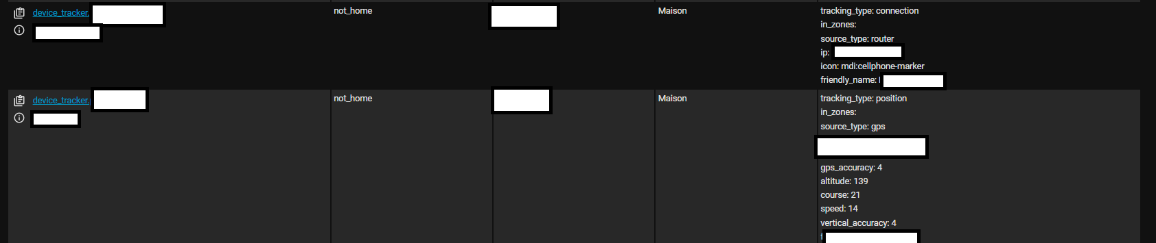

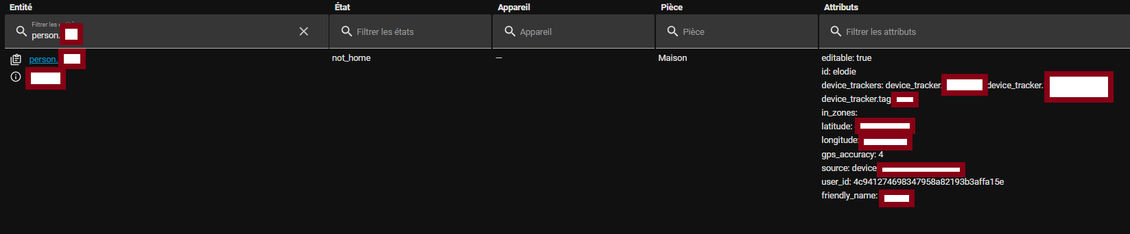

I also use the companion app’s location tracking and the phone’s Wi-Fi detection. All three of these ensure that my presence is reliably tracked.
Before, it seemed to me that if the Wi-Fi or the tag was detected at home, the person was marked as present even if the app didn’t detect them at home. Since the update, I get the impression that if the app no longer detects the person at home, they’re considered to be outside. Have the priorities changed?
Hi, i don’t know much about code. But i had problem with the way HA “read” the code. You need to put json between ’ '.
For your wifi thing, i had the problem too. Wifi and BLE are on the same level of priorities. But it keeps alternating between Wifi that has “in_zones” and BLE that doesn’t. It only takes the last one. So even, you’re still in wifi=home if you were on BLE and it’s not home for the last time, it considers you’re out.
Hope i’m clear .. anyway solve your BLE problem or disable it and it will be fine
Hey, thanks for your answer.
I’ve tried the single and double options, but I still get “unknown” in the preview, but the entity’s status is good
Even though the template does indeed return zone.home
Actually, my problem isn’t about Wi-Fi or BLE, but rather the fact that before, when a person’s device tracker was still at home, that person would show up on the map. Now, it seems to me that no matter what happens, the companion app’s location takes precedence.
EDIT :
For example, this person is detected outside:
The Wi-Fi tracker and companion are clearly outside, but the tag is still detected at home :

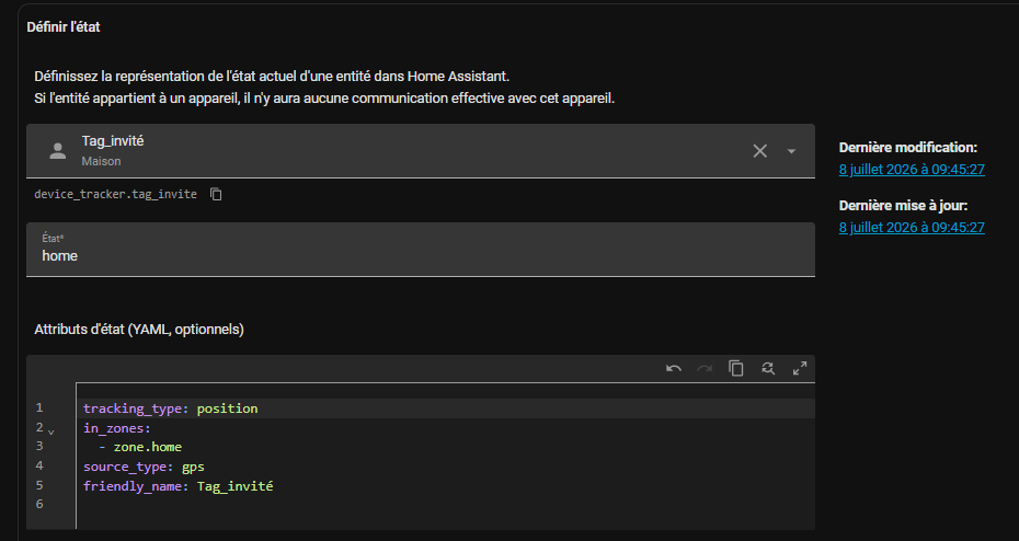

I think it’s because the source type is set to GPS? Is there a way to change it?
Add the same logic for lat/lon on the template entity. Provide None when not home, or the location of another entity.
Do you mean like that (with my latitude and longitude identical to those specified for my home zone) :
With these templates, the entity’s status is always good but the preview remains stuck at “Absent.”
On the map dashboard the tag is in the home zone.
you have to use state_attr('zone.home', 'longitude'), not "my zone.home longitude" and else none instead of else 'none'
yes that what I’ve done “my zone.home longitude” is just to explain what I put. Try with none without '. Thanks
