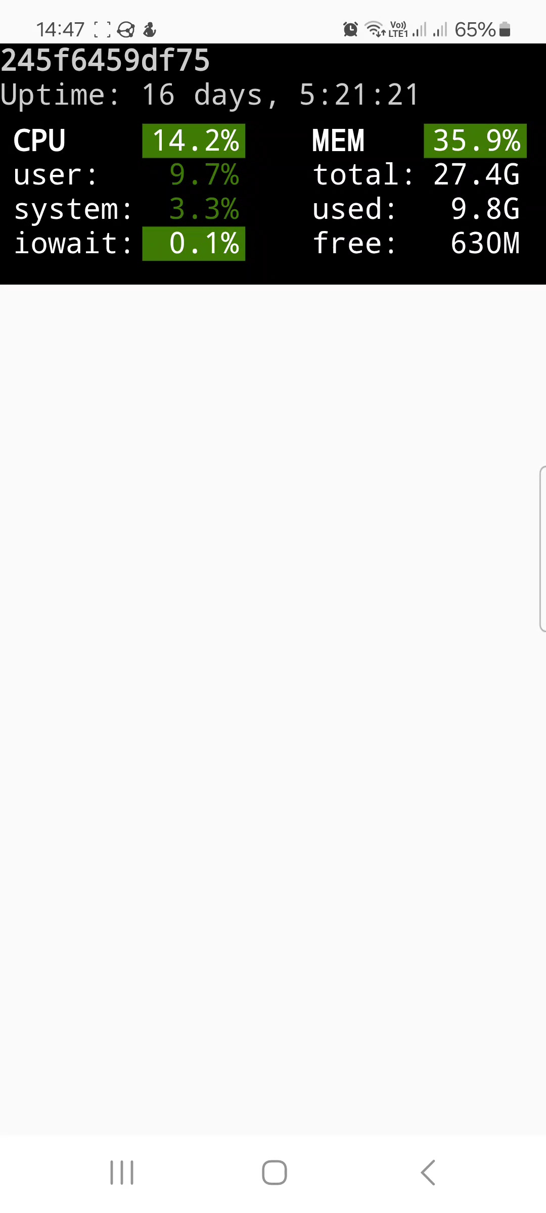

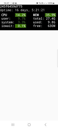

I have the similar if not the same problem. Im running ha and other addons in docker containers. When i acces any other service like frigate, glances, z2m etc it renders only first 20% of the page. Its is probably some kind of bug because prior to 2026.8 update everything was working fine for years.
If I wait some secs. , it will render completely.
For me sometimes it does but other times it doesnt render at all without either clicking on the affected page again or f5
This is how glances look. It is the same with other containers when i acces them from ha webui
