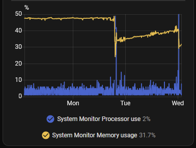

For comparison, here are my CPU/RAM stats going from 2026.4.4 to 2026.8.3 late Monday. It has been markedly lower, although I don’t quite understand that slow rise in RAM over time. That last RAM dip is following a recent system reboot. It may ultimately stabilize at the previous 48% ultimately and maybe that’s normal. This is on an RPi 4 (64).

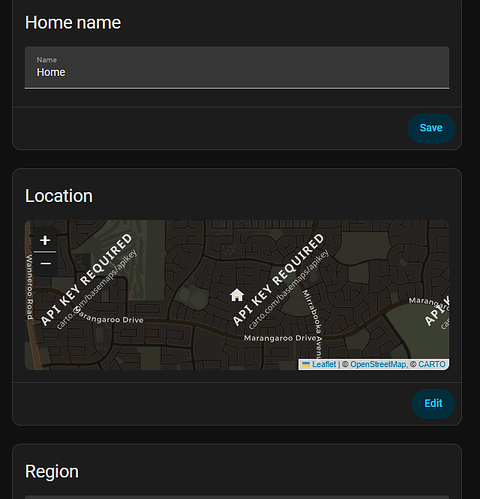

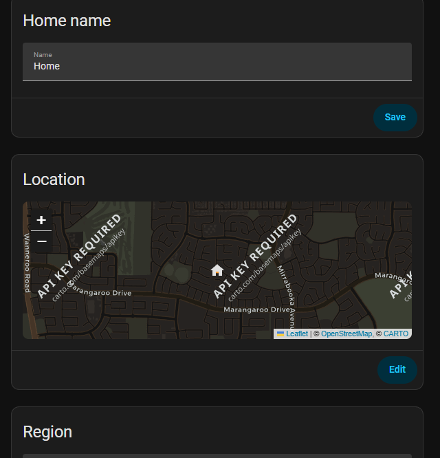

Is anyone else having issues with inbuilt map (location settings) showing “API key required”?
Anyone know the fix?
Lots of people. Hold tight for a fix.
Same for me, still on 2026.7.4. Waiting allways to update Core before see bugs is fixed
The map library ha uses now requires an api key, all version of HA will have this watermark until they figure out a path forward. It will likely be like this through next release at a minimum
This issue has already been resolved in the Custom Weather Radar Card; in the current version 3.9.0, you can simply enter the API, and the map will be displayed without a watermark again.
Perhaps this information will also be helpful for other maps.
It’s already fixed in beta, they switched to an entirely different data provider.
