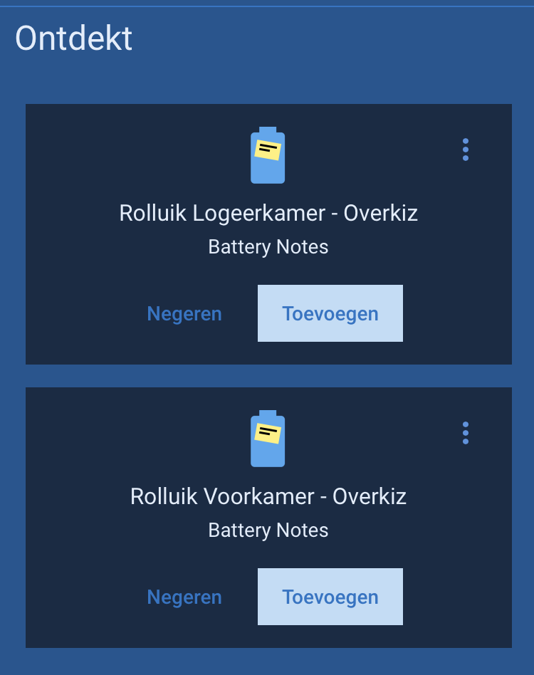

I also have 3 of those, and only 1 popped up.
as did 5 covers all of a sudden, like these
which is even more or a mystery as they dont contain any batteries. After having had a more thorough look, I still cant find how these were discovered (besides the inexplicable fact this happened only after having restarted more than 20 times this beta..)
I would hope some logger would be added so we can find why these discoveries happen
Are they Bluetooth sensors?
All my temperature and humidity sensors used in my mold indicator integration sensors are from ESPHome. No extra discoveries for me.
Battery notes appears to be a 3rd party integration. You should take that issue up with them.
Battery Notes Issue seems found
Was a newly included device definition in their library which falsely identified these mains devices as battery devices
Author took measures to fix

in my rather extensive Powerful setup, there was not a single issue, and author is well aware, and made precautions so using profiles with devices wont cause false discoveries
as it happens, is seems that HA migration didnt take care of removing the entries from the device_registry as it would have.
so they were discovered anew.
taking them out manually solved my issues, but of course that should not have happened.
I reported as such in the beta channel
