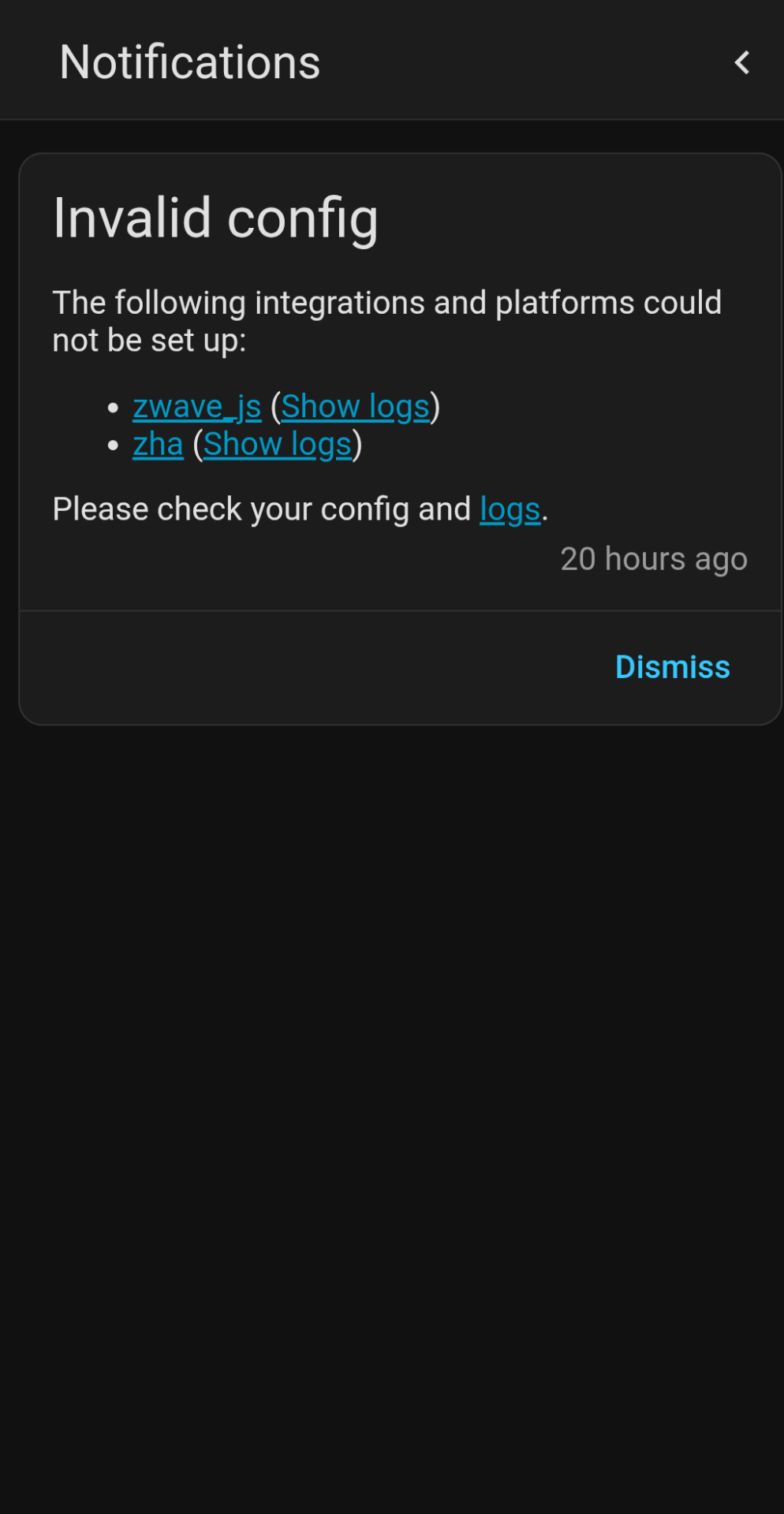

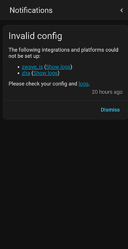

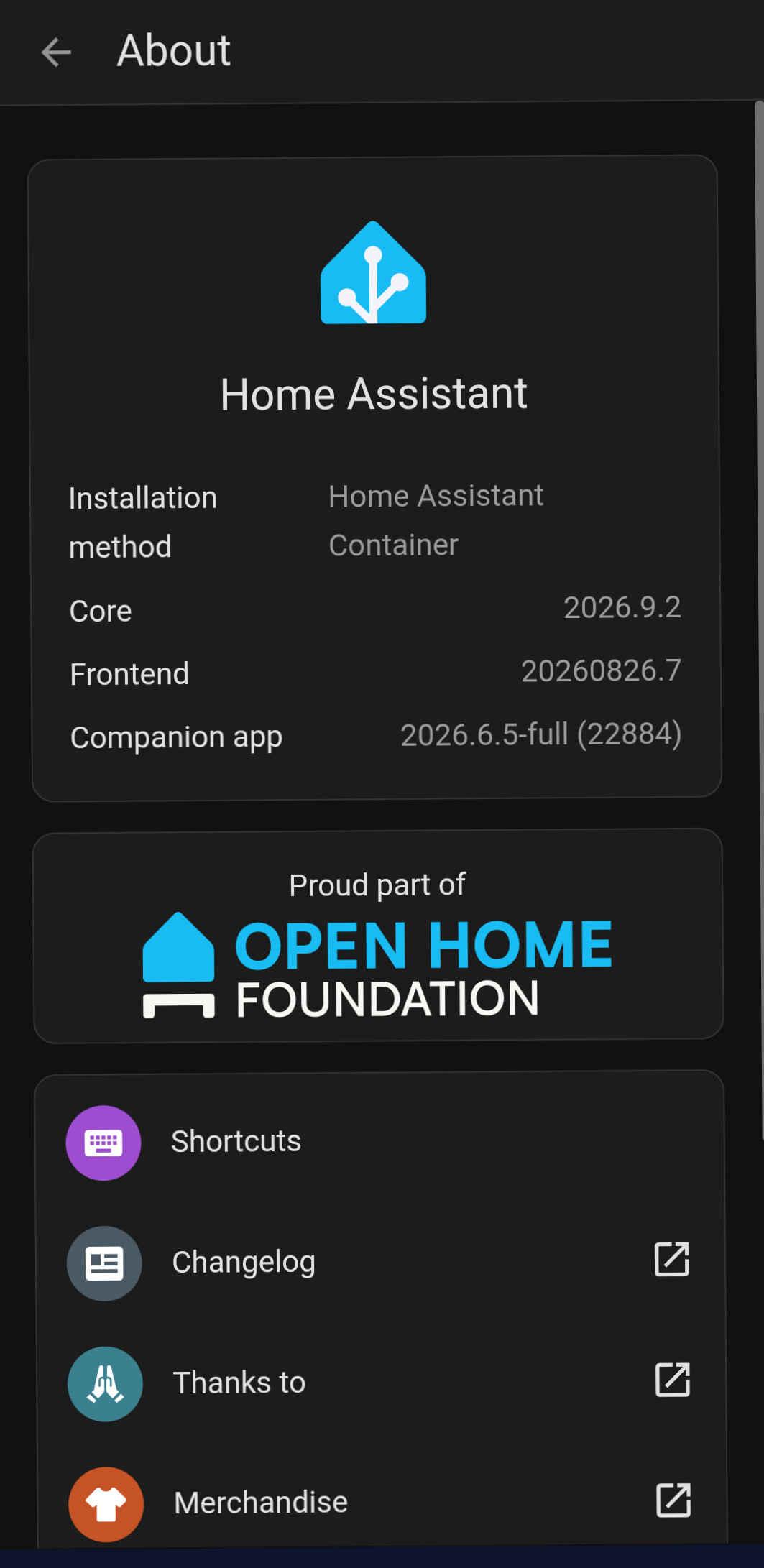

After upgrading to 2026.9.2, ZHA and Z-wave integrations no longer work. Did some minimal searching to see if I missed/could turn up anything obvious. Running docker container on an SBC for ~5 years. I don’t go more than a month without updating, usually checking/updating once a week is the norm.
Any guidance is much appreciated.

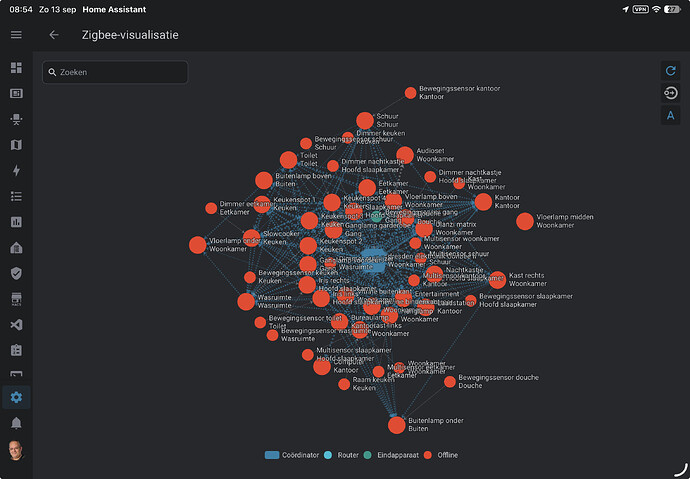

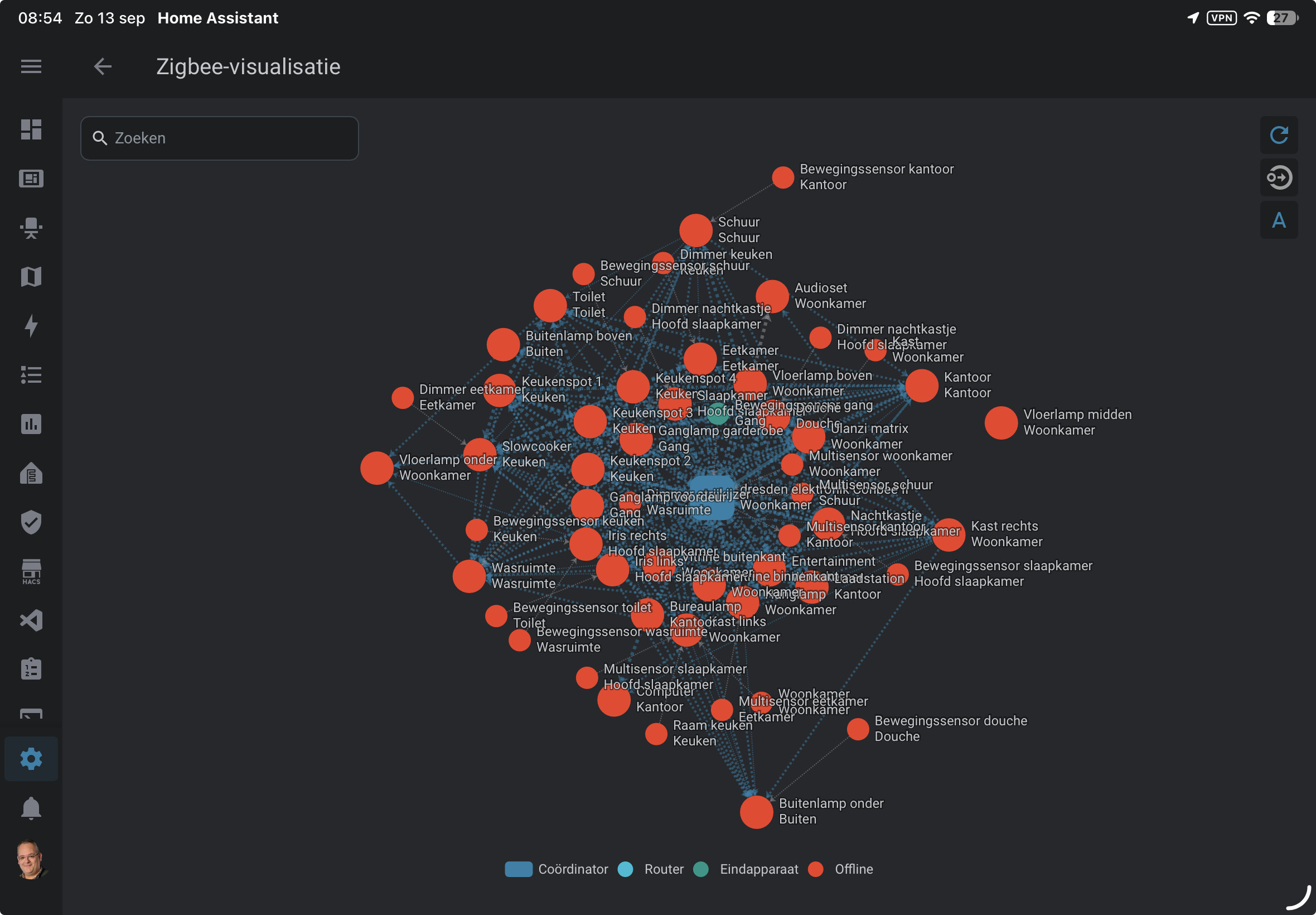

Confirming my Zigbee devices are not updating to HA ever since I installed this update, this morning. On my network, Z-Wave devices appear to be communicating normally, but Zigbee most definitely are not. Their states appear normal, but are frozen with stats = to what they were just before the upgrade. Furthermore, if I check the “Details” of Zigbee devices, I see the same thing - all the stats flatlined at that time and have remained there ever since.
FWIW, I have HA running on a headless Linux server. I restarted HA and the server, no change.

Op your install is broken… All the unable to install errors across multiple integrations… It reports can’t open file.
Its not one integration. Whatever it is is impacting the ability to read those setup files but we don’t know if they are on disk and erroring or just not there.
If your log shows disk issues yoj may want to look at it otherwise Id try to roll back(restore) and redo the updates cause I haven’t seen that string of errors but it definitely looks like am install issue (and wholly unrelated to those other items you tagged.)
I’ve seen some other issues that may have a similar signature… Failing DNS lookup causes the install to Bork. Who is your ISP and how is your DNS setup.

The issue was indeed not caused by the 2026.9.2 update. My Conbee II stick happened to die at the exact same time I installed the update. Before realizing this, I re-paired a few bulbs, but they dropped offline again after just a few minutes. I’ve switched to a ZBT-2 now and everything is working perfectly.
