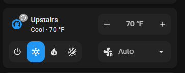

how do I remove the entity name/state reserved space ?
Do you mean the area where my screenshot shows “Upstairs” and “Cool · 70°F”? As in, you’ve hidden the name/state but the tile still reserves that space and you want the feature to expand into it?
yes Im using the tile card with climate entity and is showing the features like like yours but I removed the name and icon, but there’s still the reserved space for those. Using 2026.9 tile card
Try this:
card_mod:
  style:
      hui-card-features {
        --ha-card-feature-divider: none !important;
    ha-tile-container $: |
      .content {
        display: none !important;
      .container.inline ::slotted([slot="features-inline"]) {
        width: 100% !important;
        padding-inline-start: var(--ha-space-3) !important;
