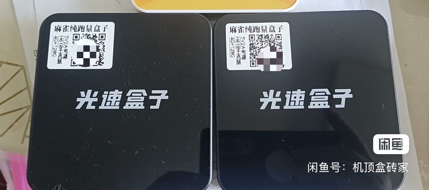

As far as I can see, externally it just has a built in line display on the front of the box which gives some status display and ‘fancy’ multi-color light on top.
Wifi 6 and BT 5.0 reported but I am not using.

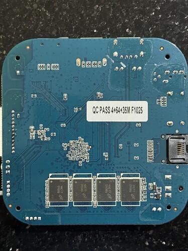

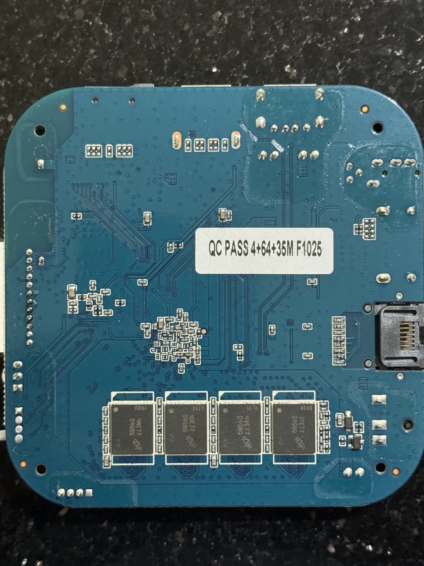

Pics of the board being added.
Under your HA build, display shows consecutively the IP, Processor use % and memory usage % - I was expecting nothing.
In TV box mode it shows time for sure in standby, and probably volume, channel etc in use… (i only ran it to check its operation so don’t remember).

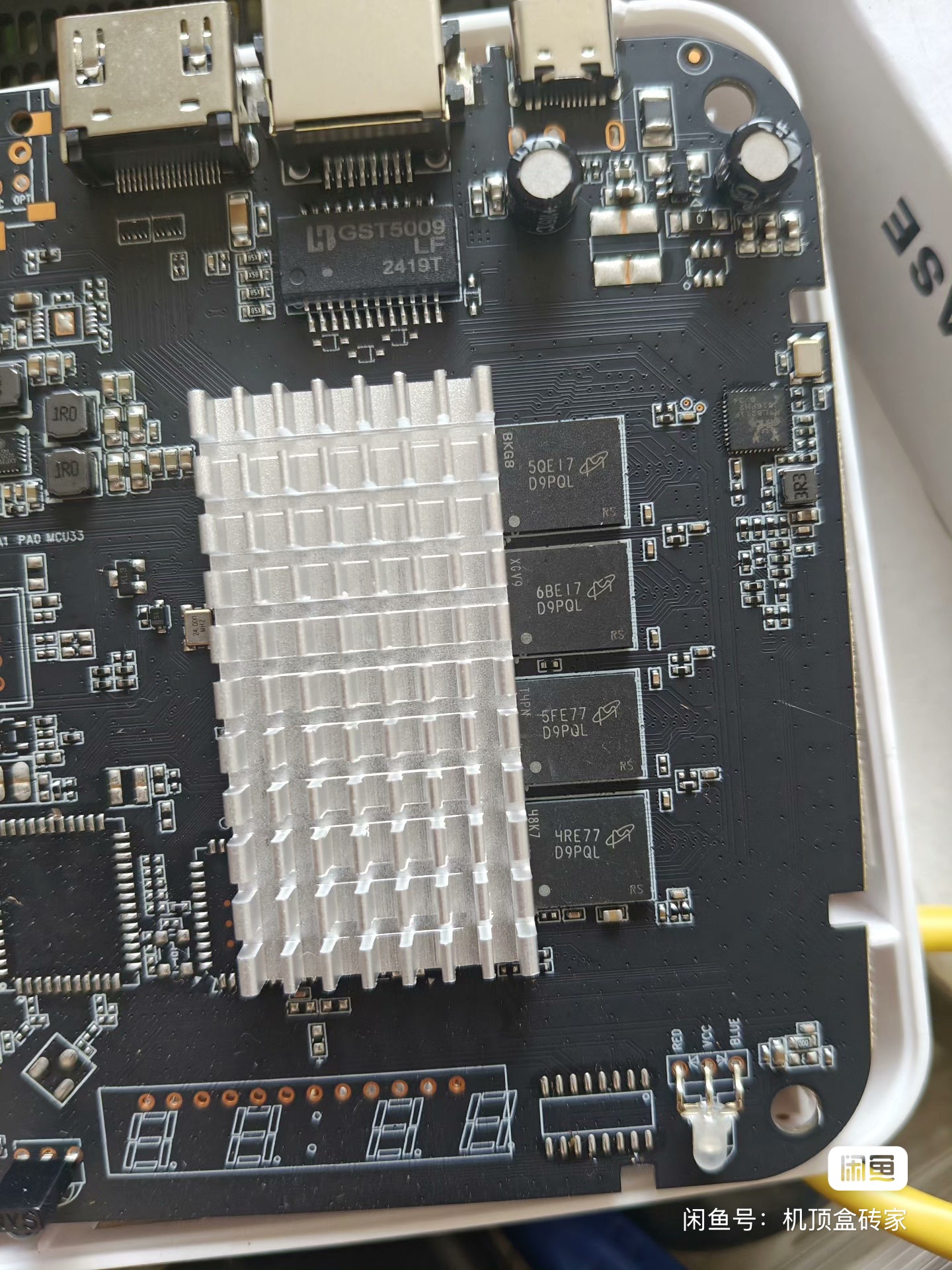

this box looks a lot like mine… did you manage to make an image of the original firmware on the 2nd one before flashing?
you can find it here

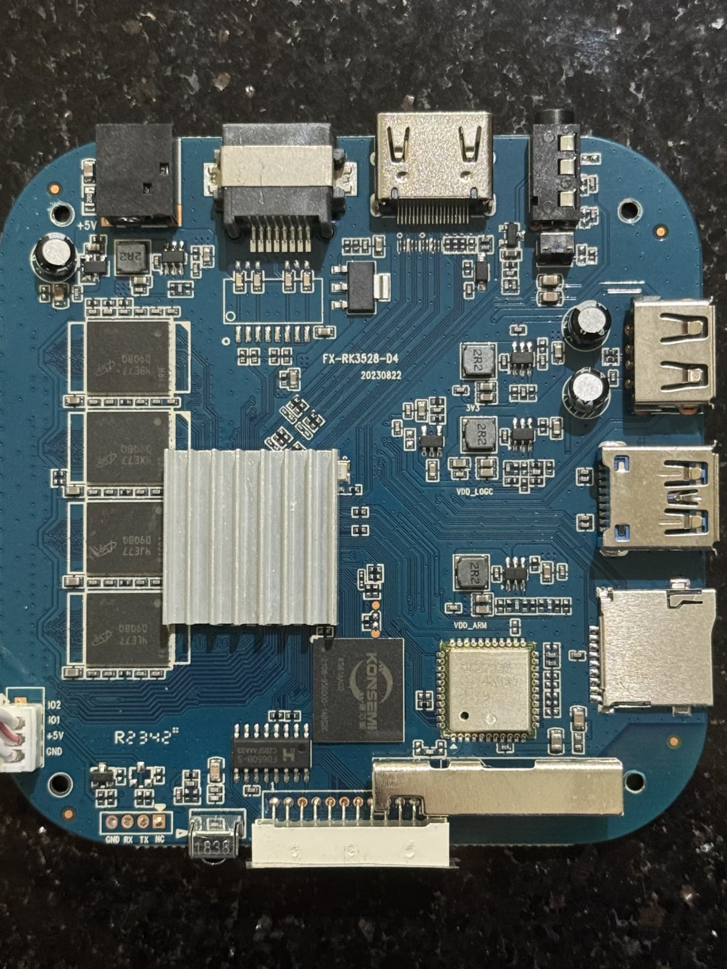

I have got a RK3528 with 4 GB/64GB however unable to boot into Maskrom method. If you @fensoft @wrongisthenwright have any image or suggestion to boot this please let me know. I have tried the multiboot option as well still I am unable to boot so currenlty the box is sitting there in my shelf.
Thanks for sharing this clear photo. I have bought similar box sometime back and searching for the Maskrom points. With your image + another forum I could find that. It is the 2 dots near the Main chip under the Aluminum heat sink shown in your picture @ 5:25 position.
