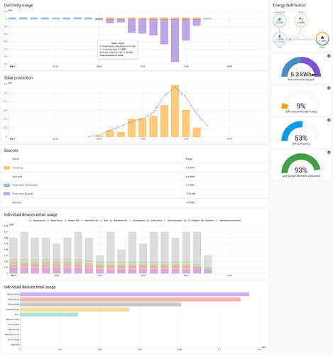

Have you tried using a utility with a day cycle for your day_kw?
Hey Tuxinator94, sorry I dont know what a utility with a day cycle is … :frowning:
I have a total kWh counter from my Huawei SmartMeter and it is this value I want to calculate every day so I know how much kWh I have been used from yesterday to today.
But how … ?
Have you tried to set up the energy dashboard?
You will get something like this:
… and this dashboard has views for daily, monthly, etc.
The data for the dashboard is coming from Huawei inverter and power meter, individual consumers of course not.
