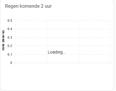

That looks like it helped creating the sensor, which is now visible.
Though the state of the sensor remains unknown, and the graph is stuck on loading.
Would i need to wait for rain for it to change?

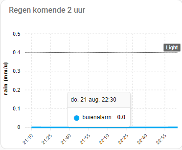

There is no error in the log.
I changed the default time out. It did not right away, but it looks like the sensor will retrieve data from now on.
The graph says it was loading for a long time.
Now it shows the line only for buienalarm…
Might show both when there is rain? or is this already a sign of an error.
So I found the issue. Which was that I left the <> in the sensor command line of the sensor, where my coordinates should be. Now the graph shows both sensors :slight_smile:
Does the buienalarm 2h sensor still work? I got the 24h graph working for both but the 2h one only works for buienradar for me. when I add buienalarm it keeps loading. Thanks!
