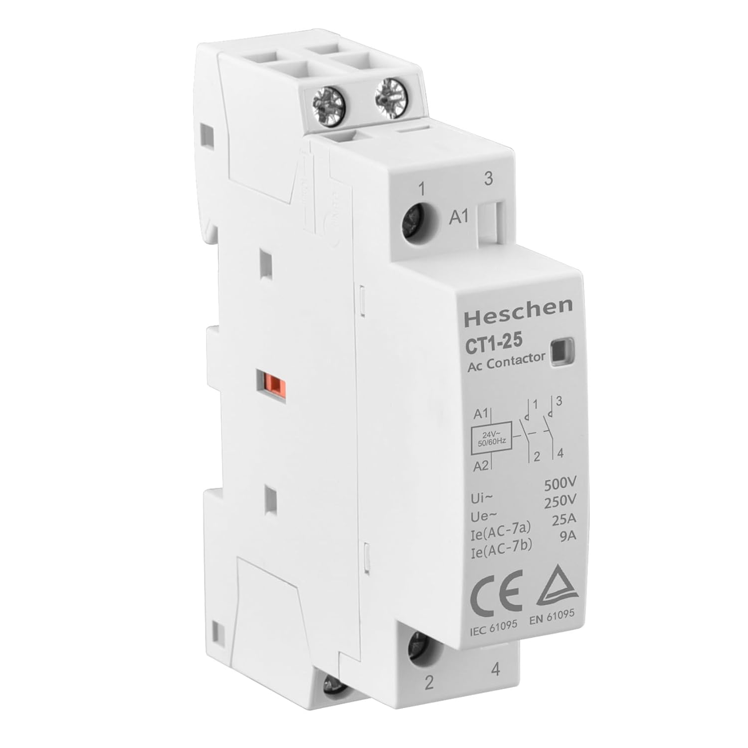

Or
https://es.aliexpress.com/item/1005001536921378.html?src=google&src=google&albch=shopping&acnt=439-079-4345&isdl=y&slnk=&plac=&mtctp=&albbt=Google_7_shopping&aff_platform=google&aff_short_key=UneMJZVf&gclsrc=aw.ds&&albagn=888888&&ds_e_adid=&ds_e_matchtype=&ds_e_device=c&ds_e_network=x&ds_e_product_group_id=&ds_e_product_id=es1005001536921378&ds_e_product_merchant_id=109161865&ds_e_product_country=ES&ds_e_product_language=es&ds_e_product_channel=online&ds_e_product_store_id=&ds_url_v=2&albcp=21840696692&albag=&isSmbAutoCall=false&needSmbHouyi=false&gad_source=1&gad_campaignid=21844625911&gclid=CjwKCAjw7vzOBhBxEiwAc7WNrxd7TAy5u06BPmf06ZS-RN4e1hdj_4WDhevwu8y_QCIDz43vxt0nnBoCP4YQAvD_BwE
Manual says Power supply voltage AC: 110 - 240 V which should cover US and EU standard voltages. The thread i sent you, they are using 110 VAC to power the device, but it’s your project.

it looks good at first glance, but it doesn’t have Wi-Fi, Zigbee, or anything like that.
