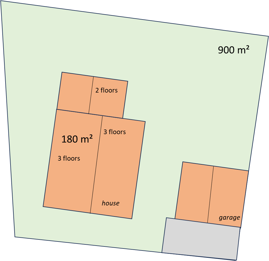

I have:
  • A detached house with solid construction and concrete ceilings, a basement, ground floor, upper floor, and a garage 10 meters away.
  • Three coordinators (2x SMLIGHT SLZB-MR4U and 1x Sonoff Max, each with 2 antennas)

  3. If so, then it’s probably better to set up three “wireless links,” each with a coordinator.
I need a device in the basement to get good Wi-Fi coverage.
Router and “master coordinator” are on the ground floor.
Another coordinator can be added on the upper floor if needed.
