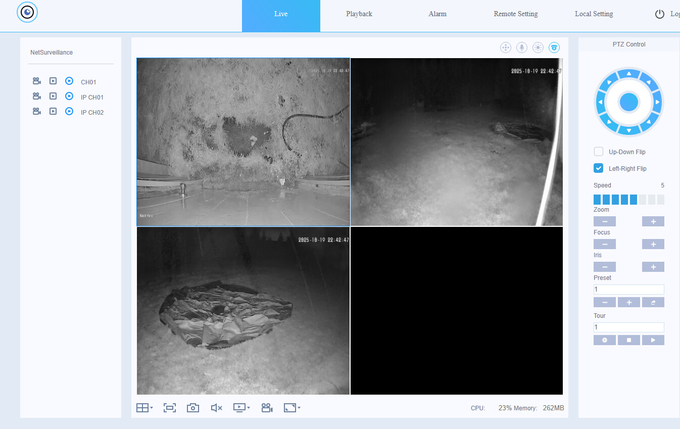

I’m on the same hunt right now with the China cam model X4-WE2Q. Like you, I can view the main lens stream via the usual RTSP stream, but I can’t access the combined stream for all three lenses or the other two individual streams. As you mentioned, I can see all three lenses through the iSee app or the videoplayertool.exe on the web. Other cheap dual-lens China cameras I’ve used combine both lenses into a single RTSP stream, but that doesn’t seem to be the case with these three-lens models. The vendor wasn’t particularly helpful either.
This is what I see in webviewer:
There’s has to be a way!
