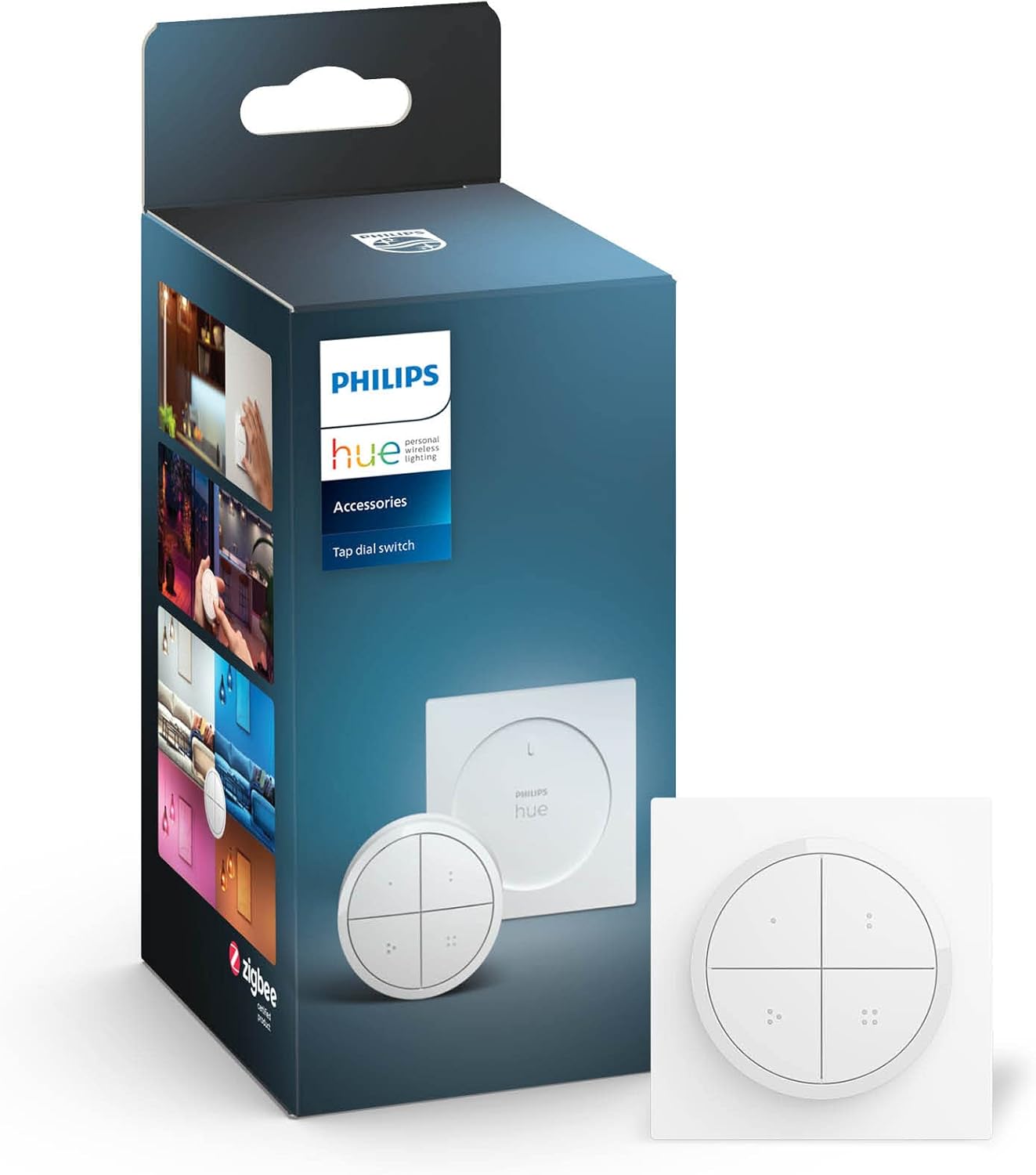

Might be (just?) outside your price range, but I have to of them and I really like them:
It has four buttons with multiple potential actions each PLUS a ring to dim/brighten lights or turn volume up/down.
does it integrate into zigbee2mqtt easily, I’ve currently got a aqara wxkg11lm but I can’t even add it to the recommended blueprint it only exposes battery, temperature and voltage
there are a few, as already mentioned… Z2M wiki / docs is the best source to see what is compatible
if I got recommended hue remote, does it expose 4 buttons which I can then add them to an automation to perform the requested task
It exposes all the actions mentioned on zigbee2mqtt.io for me.
I use this blueprint and it works fine for me - I’m sure that there are more:
I’m guessing it doesn’t need a Philips Hue Hub

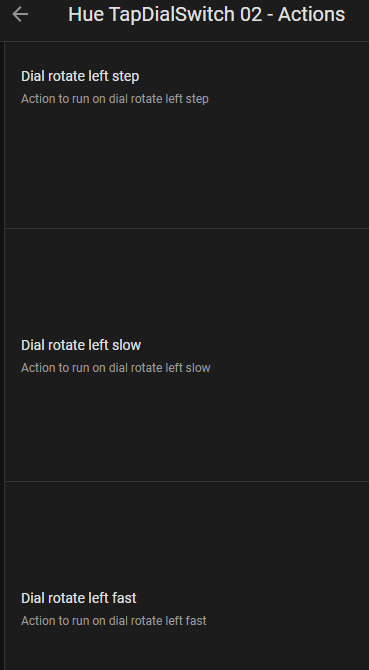

I’ve got a blueprint and have successfully added actions for buttons 1, 2, 3, 4 but stuck on the dial setup
Does your blueprint not show these entries?
yes but I don’t know how get it to adjust the brightness

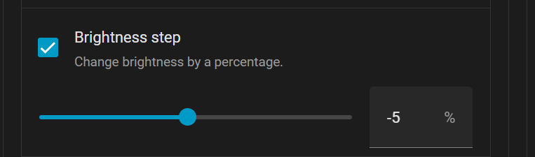

Forget about the slow & fast options for now.
Add this as an action for the Dial rotate left step
    sequence:
      - data:
          brightness_step_pct: -5
          entity_id: light.your_light
        action: light.turn_on
And this as an action for the Dial rotate right step
    sequence:
      - data:
          brightness_step_pct: 5
If you’re uncomfortable with yaml, just add this to each of the options above in the UI after selecting your light entity. (Remember to change -5 to 5 for the right rotation).
Sorted the step action, going to try the others
sorted the fast action
