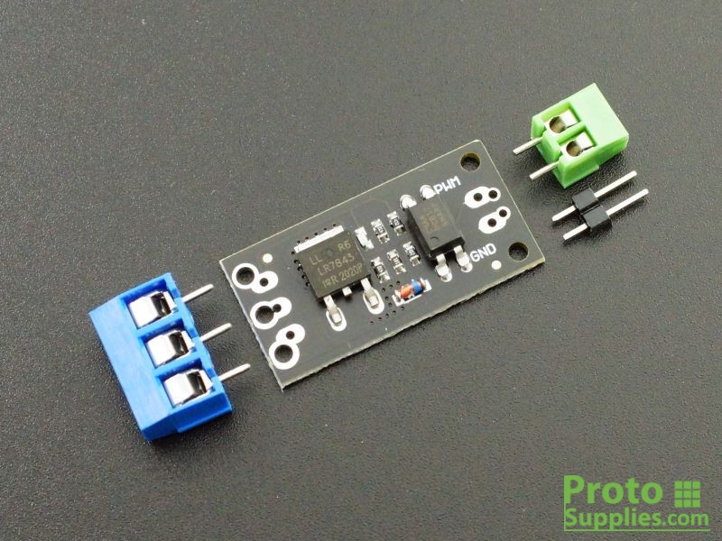

Try with mosfet module like this:
I happened to use this module recently.
I initially tried driving it directly with an ESP GPIO pin, but that failed.
I then asked Gemini, and it told me that 10V was required to drive it.
However, my fan was powered by 5V.
So, I used a 2N7000 transistor,
and it worked perfectly—the ESP GPIO could drive it directly.
Yep, the module i linked needs >6V supply.
For low power 5V fan transistor is good choice.
