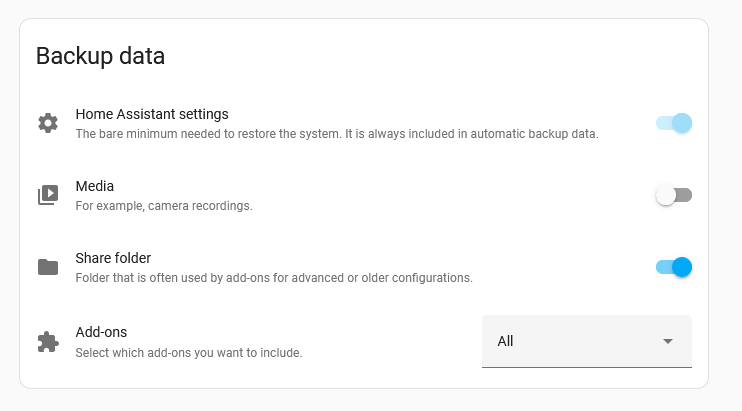

Make a backup with encryption turned off
Copy it off your device
Install the 64bit Pi4 OS
Startup HA
If the onboarding screens pops up, don’t restore a backup (often fails), but go through onboarding (create a user etc…)
once HA fully started, go to settings → system → backup, 3dots in the upper corner, upload backup
On same screen, restore backup
