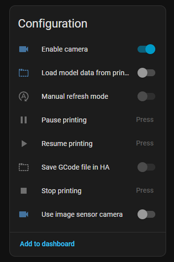

Hello! This is my first blueprint, so I hope I’m doing this right :sweat_smile:
This is a blueprint for sending a camera feed for a 3D printer to AI to try to catch problems and anomalies early. I’ve tested it as well as I reasonably can, but I’m sure there are edge cases I haven’t been able to take into account, so any feedback and suggestions are welcome!
I’ve used this with my Bambu P1S, and it seems pretty reliable, if a bit over-enthusiastic at times. I recommend tuning the threshold on the high side (I keep it around 85%) once you’re comfortable with it.
Requirements
  • A camera entity
  • A way to know that the camera should be monitored (such as a sensor)
  • A configured AI Task entity
    • If the AI Task is remote (e.g., OpenAI, Gemini), you’ll need to ensure your local media path (such as /media) is allow-listed in homeassistant.allowlist_external_dirs. This is because remote AI Tasks cannot use media-source.
  • Home Assistant 2025.8+

how do u get camera.p1s_camera? i just get image.p1s_camera…
Do you have this BambuLab integration installed? GitHub - greghesp/ha-bambulab: A Home Assistant Integration for Bambu Lab Printers
In which version is it installed?
Some month ago they released an update where the camera entity was introduced. Can you check, if you have the newest version installed?
yea i have bambu lab install Version 2.1.27, but my set up are with lan mode? don’t know if it is bc of that?
I haven’t tested with LAN mode myself, unfortunately - it might be worth checking out the GitHub to see if that helps. I also know of at least one person who had problems that was able to resolve them by reinstalling the integration - that might be worth a try if it’s not too disruptive.
Your use case brings up a good point, though - you shouldn’t need a camera, just an image. I’m working on an update (testing takes forever since I try to run a few print cycles to verify everything), and I’ll look into allowing an image entity instead of a camera to fit your scenario.
Just to check - is “Use image sensor camera” off in your setup?
ooh that did the trick!
