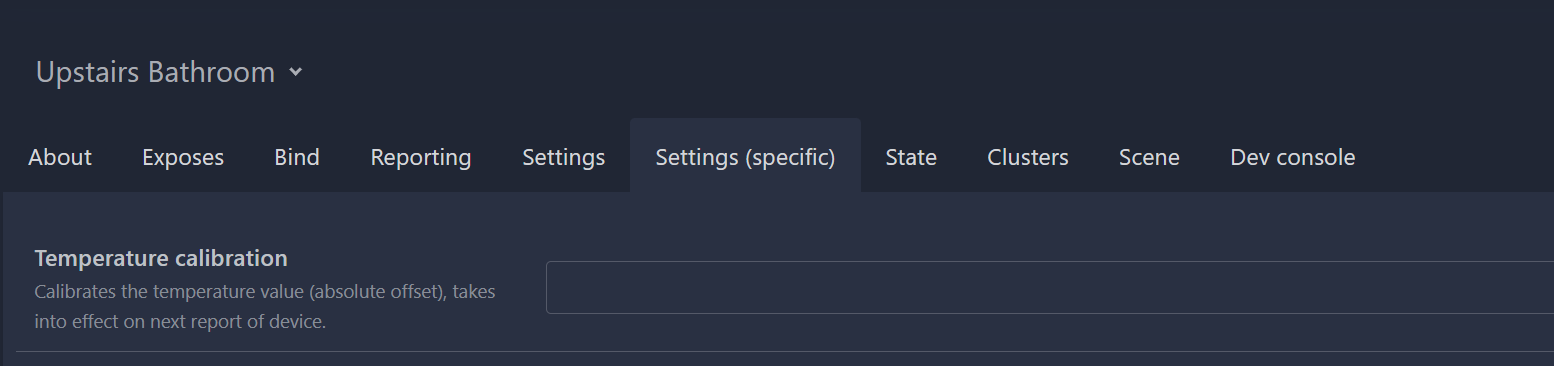

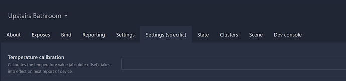

Go to the device page inside Z2M interface > click Settings (Specific) and set the Temperature Calibration from there:
Try with -10, but make sure to press the button on the device to wake it up just before entering the value. Monitor for a while and adjust if necessary, keeping track of the sum of positive/negative values you applied to the device as a final value. Apply the final value to the other device - job done.

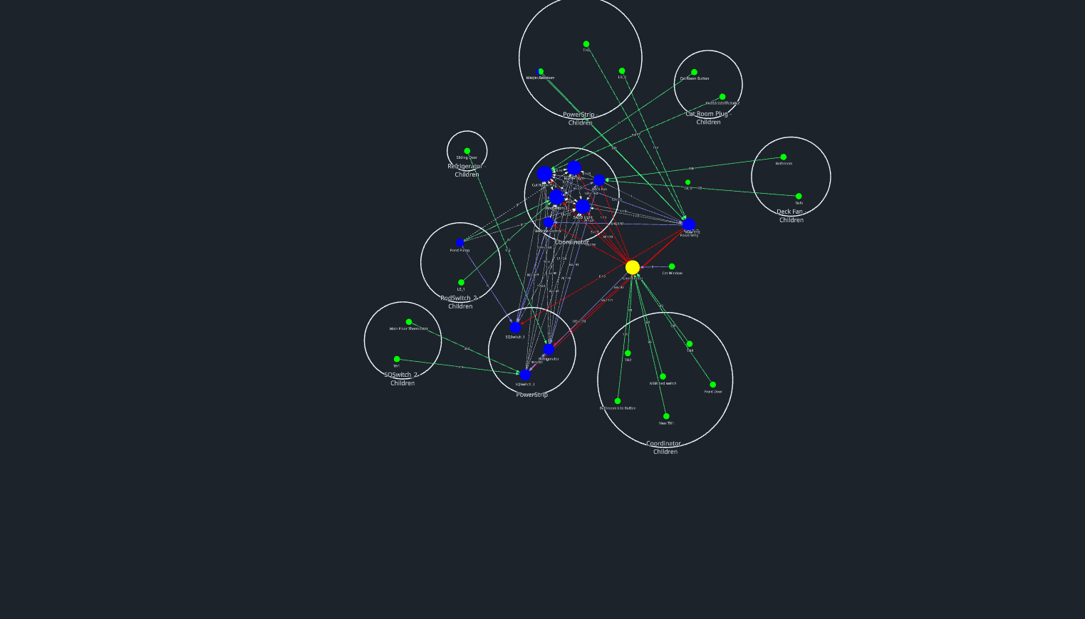

What does your zigbee map look like? Are the majority of devices connected directly to the coordinator?
Routers is the key
Geez I never imagined that number would be that low. Now I really need to get more educated on this. I’ll get a map together, Thanks
I just did a quick count. I have 12 routers and 21 endpoints. I created a map and it looked like I made pasta and threw it on the floor. So if routers are the key to getting more devices connected how do I make them work to my advantage. If there is a tutorial somewhere please advise.

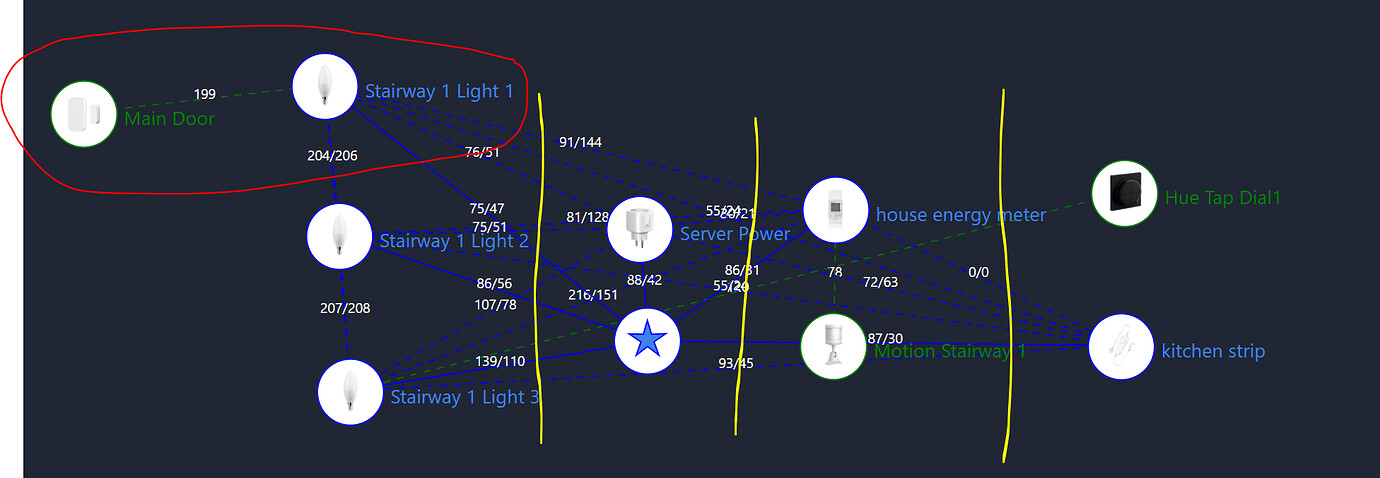

You can drag devices around (gently) on the map :rofl:
Ignore the yellow & red markings - it’s an image I reused from another post.
so I coul drag an endpoint to a router and it would use that?
