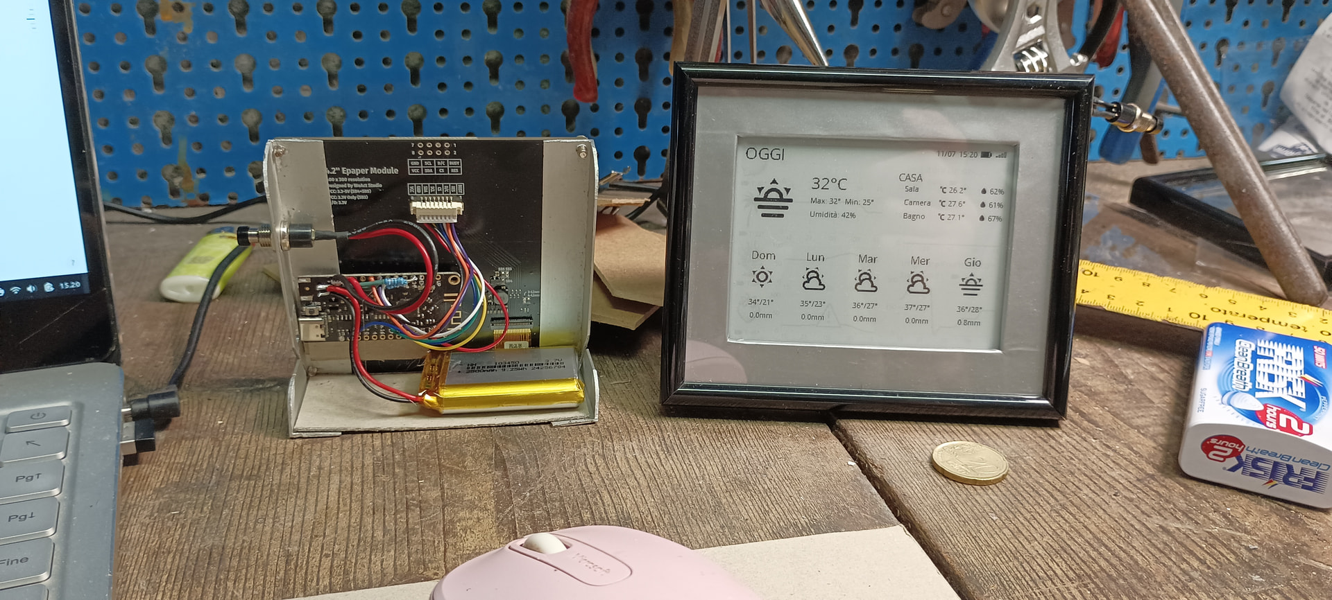

  • Hardware: Lolin Lite 32 with a battery powering a 4" WeAct E-Paper display.
  • The “Terminator-One”: This is my current test board setup.
The Code & The Frame
I didn’t write a single line of this code. AI did it for me. My job is simply trying to give it a sensible layout and form factor for my family’s needs.
Right now, my production board looks a bit messy and is mostly held together by tape, but hey, what can you do? Creating a beautiful, clean frame for a 4" E-Ink display is incredibly hard!
Here are some photos of my “Terminator-One” test setup and the current state of the frame. I would love to hear your thoughts, especially if anyone has tips on making a cleaner DIY enclosure!

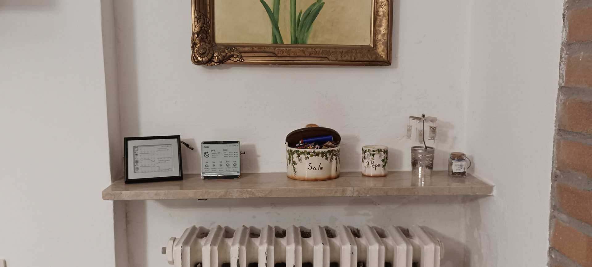

Forgot to mention: the button allows you to cycle through the different displays. I have one for the garden that shows soil moisture and water usage (via Sonoff irrigators), one for the weather, another (not pictured) for the home climate—tracking room temperature, humidity, and heat pump status—and one that keeps the board awake for OTA updates (along with some additional info).
The whole family is acting like nothing happened, as if I hadn’t put the displays on the shelf, but yesterday my daughter asked me: ‘Dad, why is there an exclamation mark on the strawberry curve graph?’. I answered with some trepidation: ‘Because it’s warning you that the soil moisture for the berry patch in the garden is low and needs watering’.
