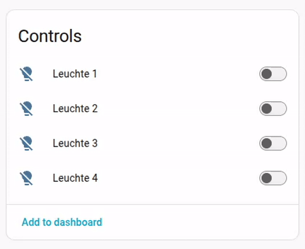

As I could not post all embedded media in the first post, here is some additional information:
This is mode 1
mode1

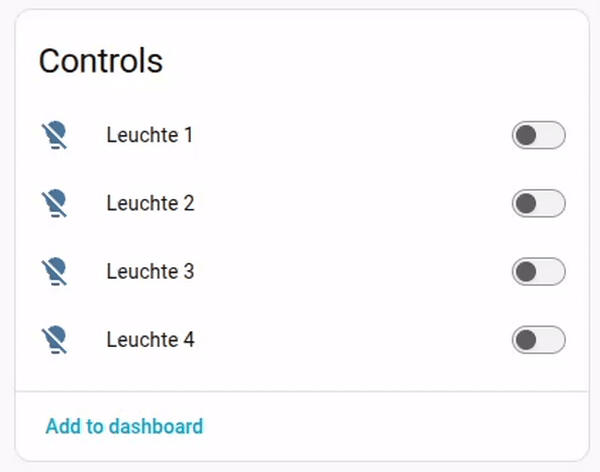

This is mode 2
mode2

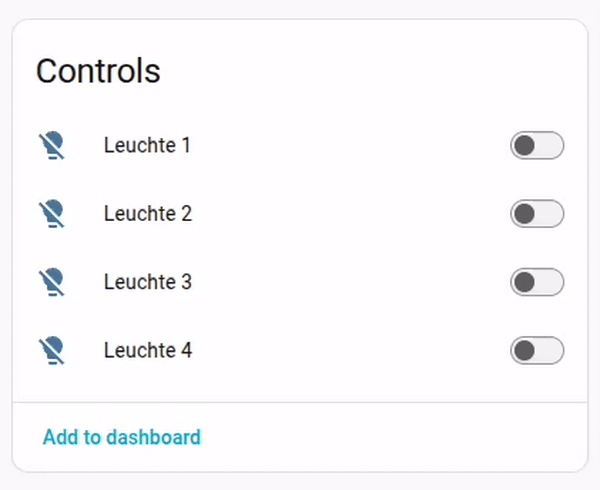

This is mode 3
mode3
