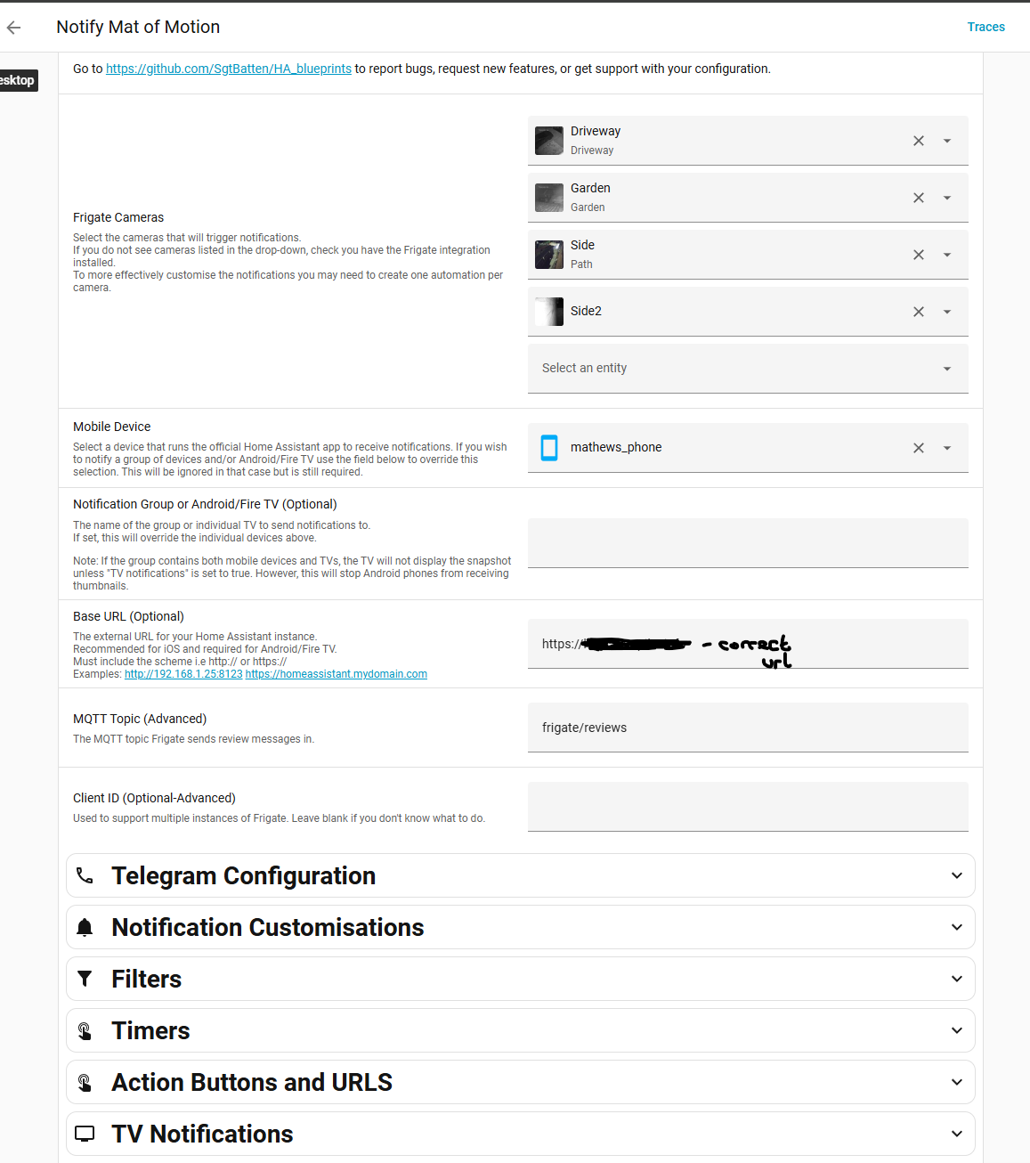

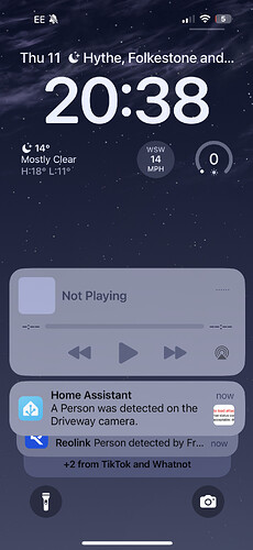

Hi, I am trying to set up an automation to notify me of events from my cameras. I have used the blueprint UI and have my HA external URL working fine. When the notification comes through, the snapshot image on the banner itself shows a 404 error. When I click on any of the links on the notification ie. view snapshot or view clip they work perfectly as well as the live stream.
I have tried reinstalling / configuring etc, I have added a delay, I have checked all my links / urls etc and I cannot find the issue.
Automation:
alias: Notify Mat of Motion
description: ""
use_blueprint:
  path: SgtBatten/Stable.yaml
  input:
    camera:
      - camera.driveway
      - camera.garden
      - camera.side
      - camera.side2
    notify_device: bdd83aca997a2490498c53264c3127c2
    base_url: https://ha.35turnpike.info
    video: >-
      {{base_url}}/api/frigate{{client_id}}/notifications/{{id}}/{{camera}}/master.m3u8
    final_update: true
    tap_action: >-
      {{base_url}}/api/camera_proxy_stream/camera.{{trigger.payload_json['after']['camera']
      | lower | replace('-','_')}}?token={{state_attr( 'camera.' ~ camera,
      'access_token')}}
    url_1: >-
      'access_token')}}
    initial_delay: 2
    attachment: "{{base_url}}/api/frigate{{client_id}}/notifications/{{id}}/snapshot.jpg"
    cooldown: 60
    button_1: Live View
