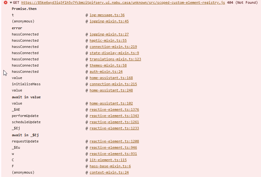

I’m trying to set up a custom card but getting lots of 404 errors in the browser from webpack dependencies, like these:
GET http://homeassistant.local:8123/unknown/src/scoped-custom-element-registry.js 404 (Not Found)
GET http://homeassistant.local:8123/unknown/src/lit-html.ts 404 (Not Found)

Still getting this error myself
I am seeing that error too. Not getting any issues despite it though.
Same issue on my instance. Any details about this behaviour?
