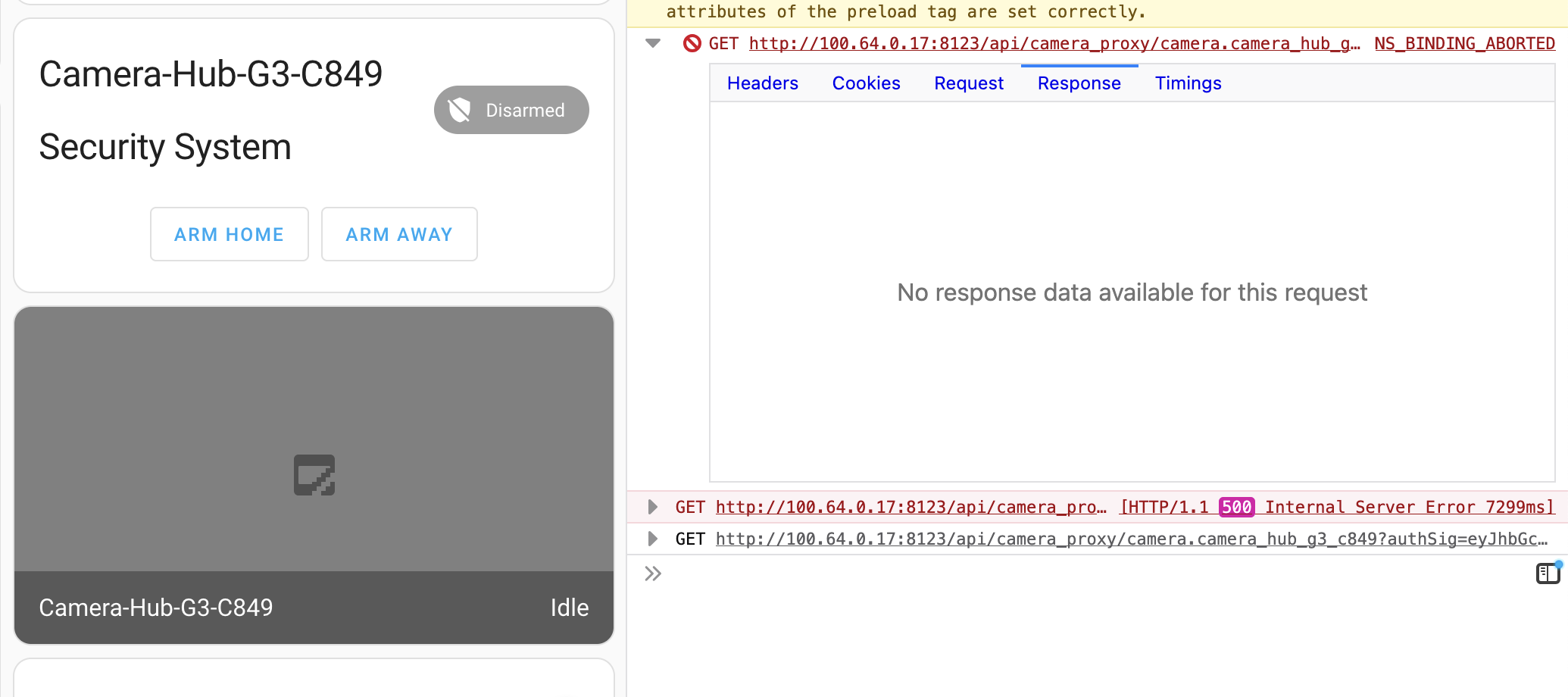

I have a camera that at one point was working on home assistant. It is a Aqara g3 camera. It used to display inside the webui and I could see video/images. Now, it does not work, and I see in the javascript console that the endpoint it attempts to use returns a 500 error. I am using docker (well, podman) to host and I don’t see anything in the logs for the container. I don’t fully understand all the components, but I believe I had to install the Matter server (also using podman/docker) to get this camera working. I don’t see logs in that Matter container either. I’ve tried restarting the docker containers, and this has not fixed things.
The URL it is hitting is: http://100.64.0.17:8123/api/camera_proxy/camera.camera_hub_g3_c849?authSig=eyJhbG...
How do I troubleshoot this?

Nothing is displayed in the javascript console other than the URL it appears to hang on.
http://100.64.0.17:8123/api/config/config_entries/flow/01JTK6B3TXH3TD8X38MS72RSXA
