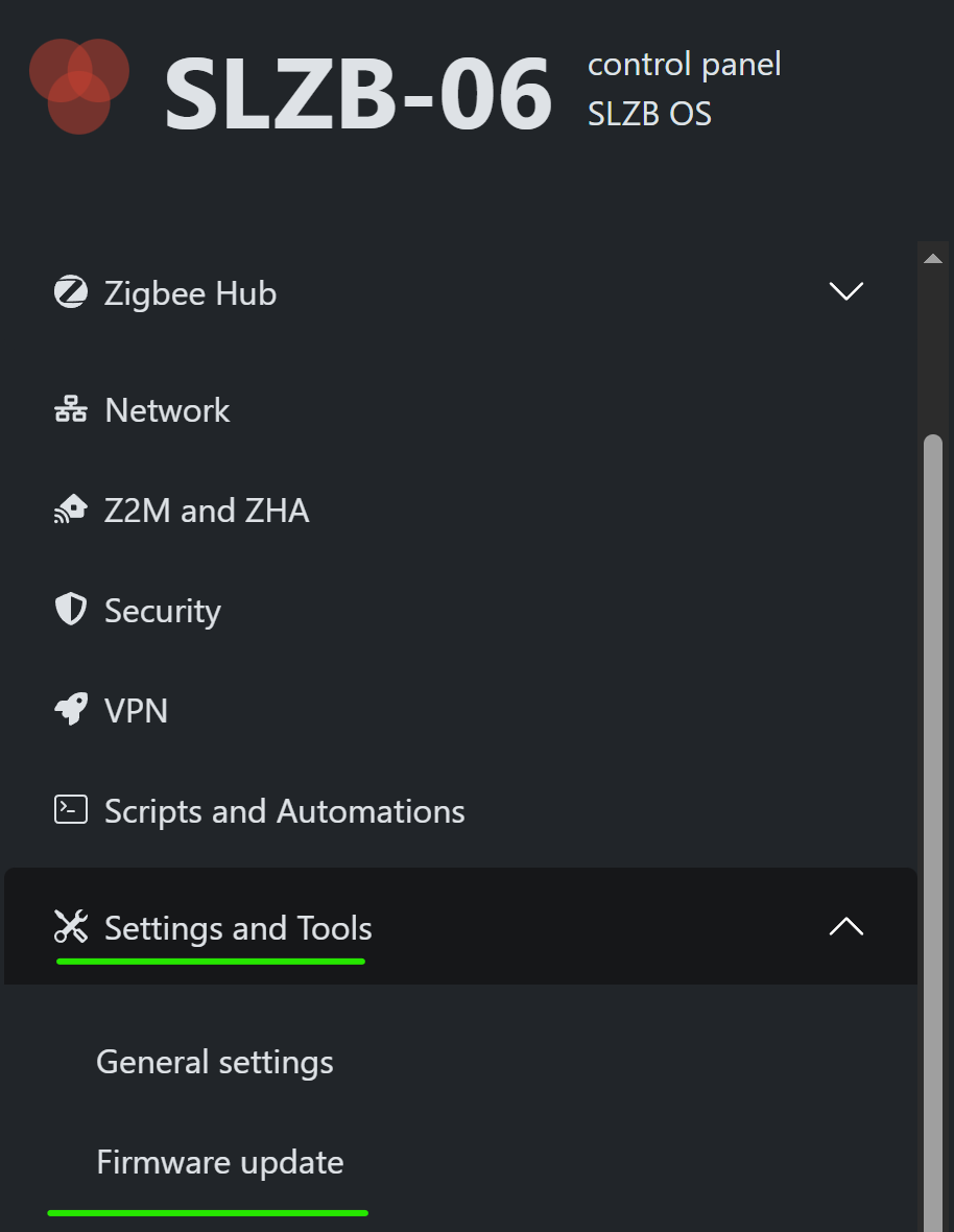

I always use the SLZB’s built-in UI for firmware updates. It’s accessible via the device’s IP or http://slzb-06
Go to Settings and Tools and select Firmware Update
I currently running Firmware version: 20250325 with v2.9.2
I’ve updated via the web interface for the device (thanks for the suggestion!).
