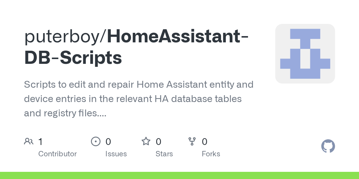

6 Routines to Delete/Rename/Move Devices & Entities and their corresponding registry entries, data, and metadata
If I want to delete multiple devices or entities, I would typically look through core.device_registry and core.entity_registry, respectively to find either the full names or the ids of the desired devices or entities, using either grep or if you want to parse the json code in a more sophisticated manner, use jq
If you have a lot of devices and want to automate, then use a bash for loop to iterate through the desired list of devices or entities, calling the relevant delete routine and flags on each iteration.
My code is written in the spirit of Linux – it is a routine that does what it needs to do – no more, no less. If you want to add on more specific functionality then you chain it through other standard Linux and bash commands to get your desired result.
BE CAREFUL - and test your bash command before proceeding.
If this doesn’t make sense, then I suggest you not try it because I fear you might lack the knowledge and experience to do this low-level and potentially destructive editing of HA registries and databases.
While I have added various tests and backups to make this code as safe as possible, fundamentally it can mess up your system if you don’t know what you are doing… so buyer beware…

For latest versions see:
