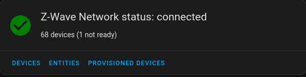

68 devices (1 not ready)
I have a situation where I have one device not ready and I can’t figure out why.
I have checked the integration diagnostic file and can’t find it.
I have checked the zwave log on what it sees (ie. Z-Wave Classic nodes: 1, 2, 3, 4, 5, 8, 9, 10, 11, 12, 16, 19, 20, 22, 23, 24, 31, 32, 33, 35, 36, 37, 39, 42, 47, 48, 49, 50, 51, 53, 54, 55, 56, 58, 59, 60, 62, 63, 65, 66, 67, 68, 69, 70, 71, 72, 73, 74, 76, 78, 81, 84, 85, 86, 87, 89, 90, 91, 92, 94, 95, 97, 98, 102, 103, 104, 109)
I checked via the Simplicity Studio and only 67 nodes are on the network.
Any idea where else to look? Note that I am not using “Z-Wave JS UI”.
resolved … had a free provisioned nodes that where adding to the counts.
