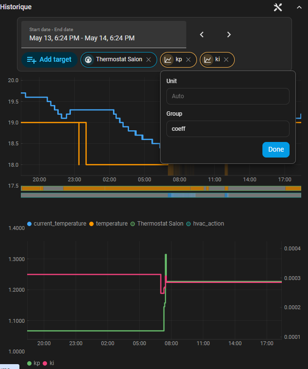

Mixing attributes in the same chart — HA doesn't expose units for attributes, so to group multiple attributes on a shared Y-axis you have two options:
  • Set a unit directly on the attribute (e.g. °C, or the special key temperature which handles both °C and °F transparently).
  • Set a Group: give the same group name to all entities/attributes you want on the same axis. This works even across different unit types.

Right-click (or long-press on mobile) on an attribute chip at the top of the chart to open the grouping panel.
Assigning a numeric group value (1, 2, …) places that series on the 1st, 2nd, … chart respectively.

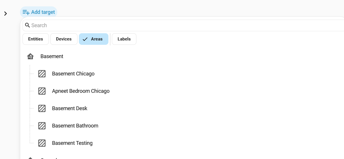

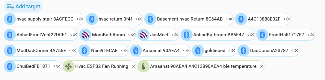

This looks awesome - Ive had to manually create “attribute as entities” for a bunch of devices just so i can graph their info.
Big feature request: the native history *(not history card) lets you add devices, labels, floors and areas as a target, not just entities.
It even lets you expand the list - you can start with a label, expand it to show all individual devices, then further expand to show the sub entities (and then remove specific entities etc)
The big downside is it doesn’t let you save that dynamic view as a card.
If you save the view to a card, it does so by statically including the list.
Any chance of porting that part of the native history view to this card?

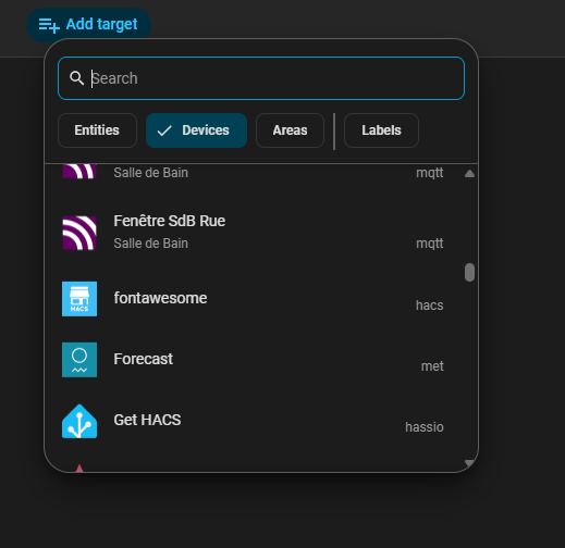

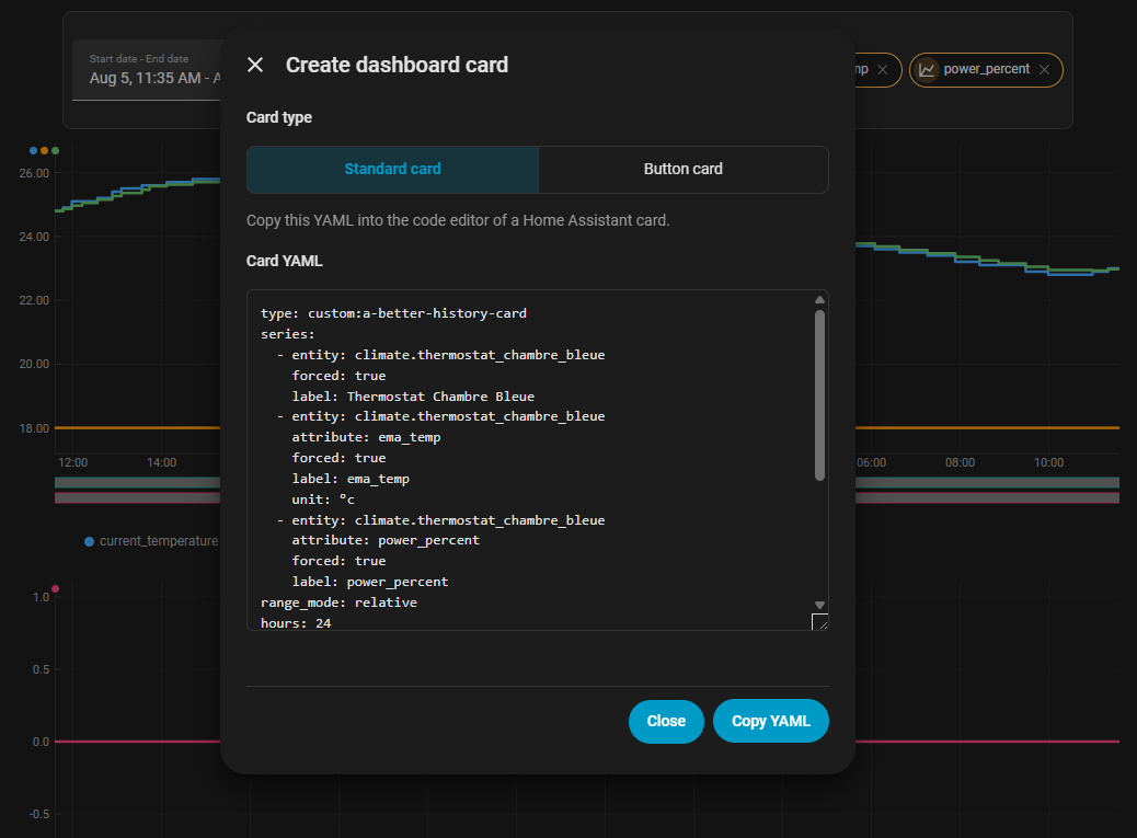

@AJolly try 0.3.0
I have added the label/devices/rooms selector
Also you can now export the current chart as a card

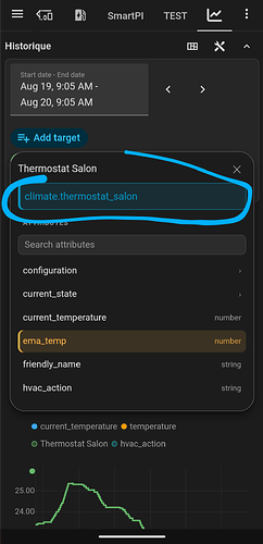

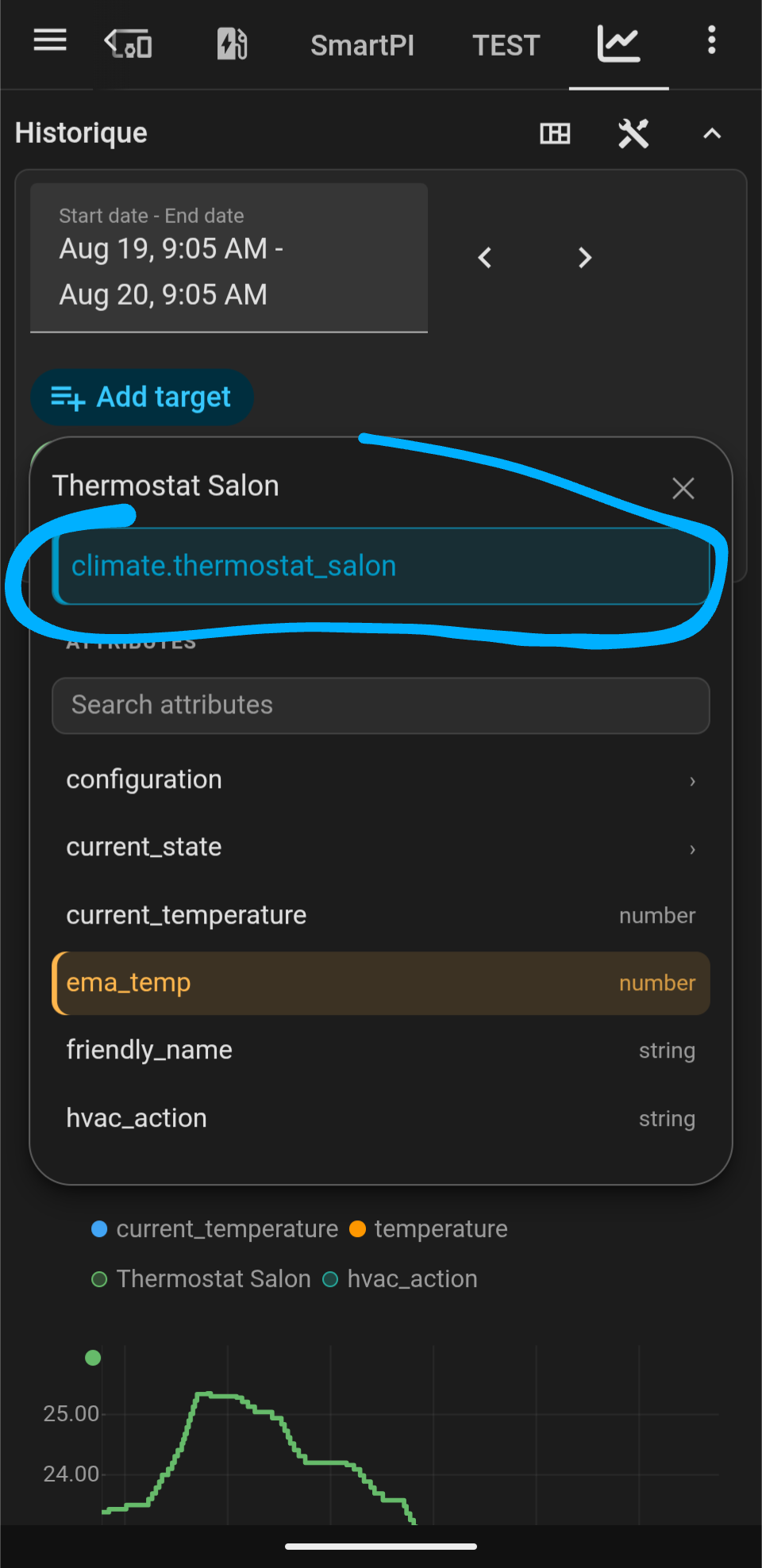

I’ve installed the card & rebooted. When I try to create a card it either can’t see a sensor entity or can & it claims to save, but what I’ve entered disappears so the card is empty. What am I doing wrong?
@Gnat54 When you’ve selected an entity, it should open a new selector where you can select the whole entity ( in blue ) , or some attributes ( orange )
