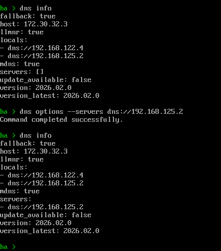

I have my own internal DNS servers - which properly resolve things like “a0d7b954-zwavejs2mqtt.local.hass.io” - but when in a SSH shell on HA, they do not resolv unless pointing to my general network dns server (192.168.125.2) versus what /etc/resolve.conf points to (172.30.32.3) which results in 172.30.32.3#53 unreachable – even though the main HA console page reports the local address as being 172.30.32.3.

I think I may have fixed it.
This thread talks about the ‘dns info’ showing “locals” but no “servers” for one user.
I was also showing my two network servers in the System->Network->IPv4 config in the “locals” field - but nothing in servers.
So I added my main LAN DNS server and <poof!> Zwave came back up and now (once enabled) has Met.no

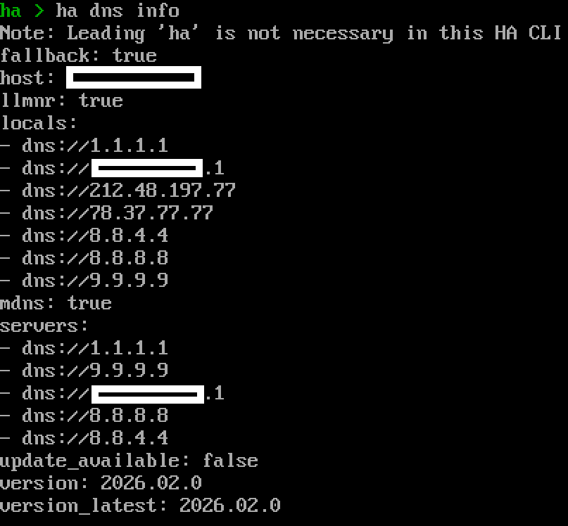

I added my locals (1.1.1.1 and 8.8.8.8) to servers as you suggested and rebooted and that didn’t seem to help either. I only reloaded the integrations though. Did you reinstall them from scratch?
Otherwise, my ha dns settings are the same, but still no luck. This is not my strong suit - should I be changing things in UniFi?

Tried all of it, but no luck. Is it fundamental HA problem and I just need to wait for the update which will fix this?
