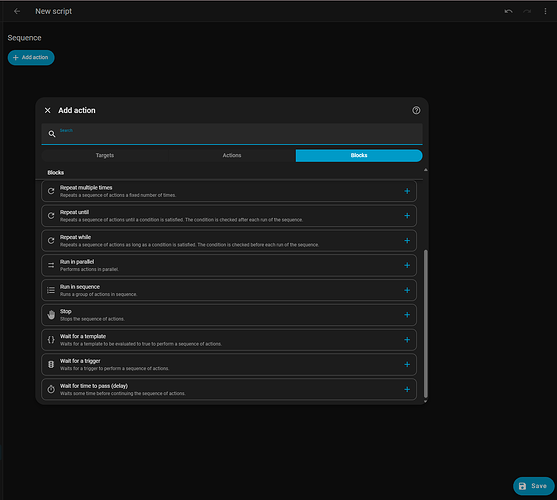

But broadly, yes, this should be doable in a cleaner way. I’d be looking at a wait_for_trigger or wait_template with a timeout, so it continues as soon as the sensor changes, but gives up after whatever limit you set and moves on. Home Assistant scripts support both waiting for a trigger/condition and adding a timeout, with control over whether the script continues after the timeout.

I think that you may have nailed the solution in your first post.
I did, and it told me that I shouldn’t make presumptions that the existing code was inelegant because standards of beauty were often cultural and changed with time.
