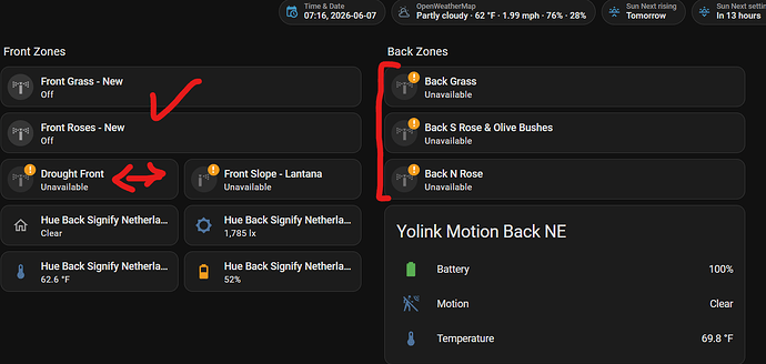

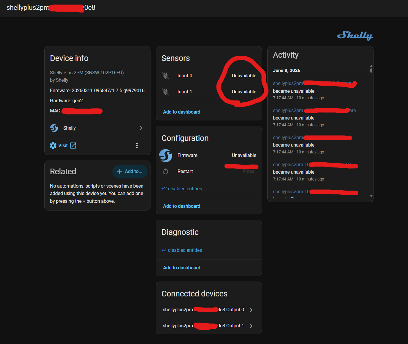

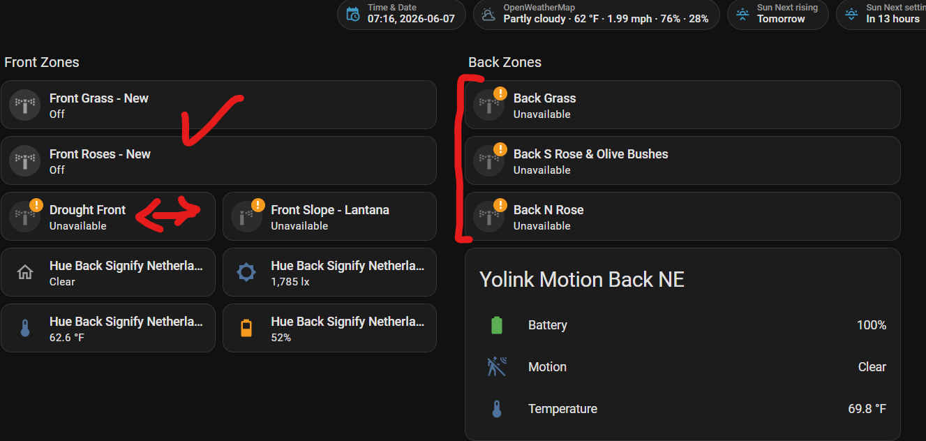

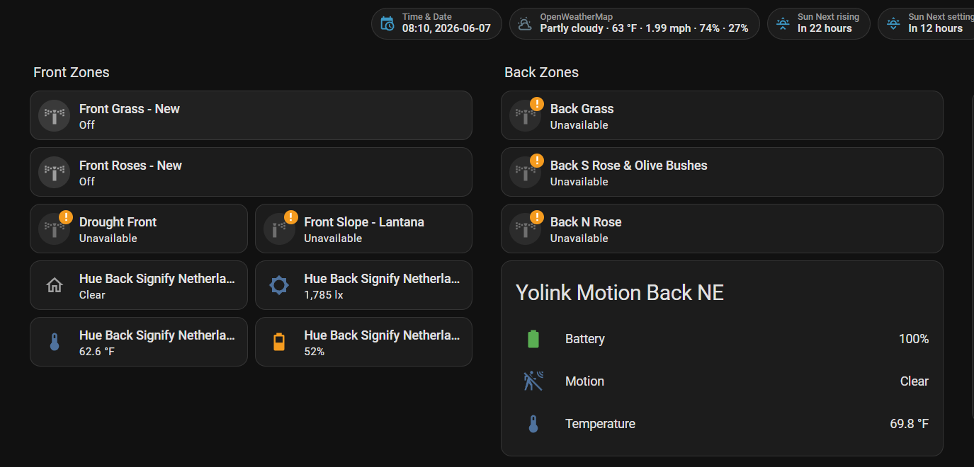

A couple of my Shelly Plus 2PM & Shelly Plus 1 fail to load in HA
Even though these "Shelly Plus 2PM" & "Shelly Plus 1" switches are available and fully functional in my Shelly iOS app, but they consistently fail to load in HA!

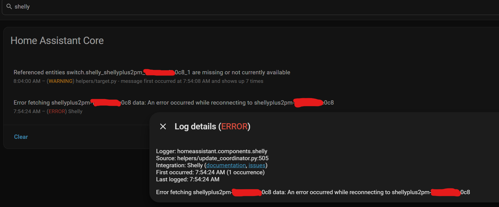

I can't figure out why this is happening. here are some captures for your reference:

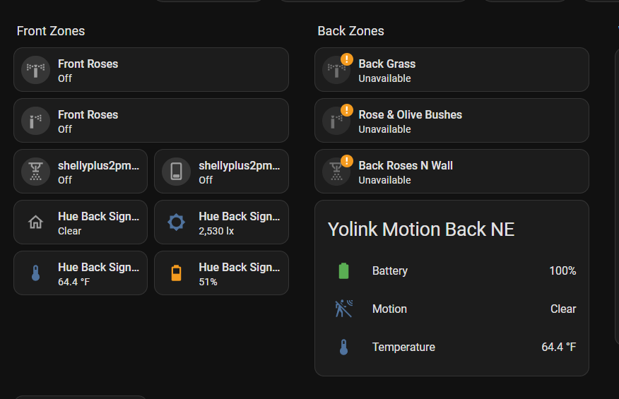

Before reboot:
Sometime I re-start HA with a "Reboot System", sometime it they all come back but sometimes they don't. The following is after the most current reboot.
After reboot:
How can I fix this?
What can I show you to trouble shoot this issue?

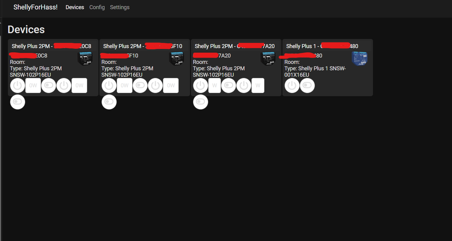

{"name":null,"id":"shellyplus2pm-***c8","mac":"***C8","slot":1,"model":"SNSW-102P16EU","gen":2,"fw_id":"20260311-095847/1.7.5-g9979d16","ver":"1.7.5","app":"Plus2PM","auth_en":false,"auth_domain":null,"profile":"switch","provision":"complete"}

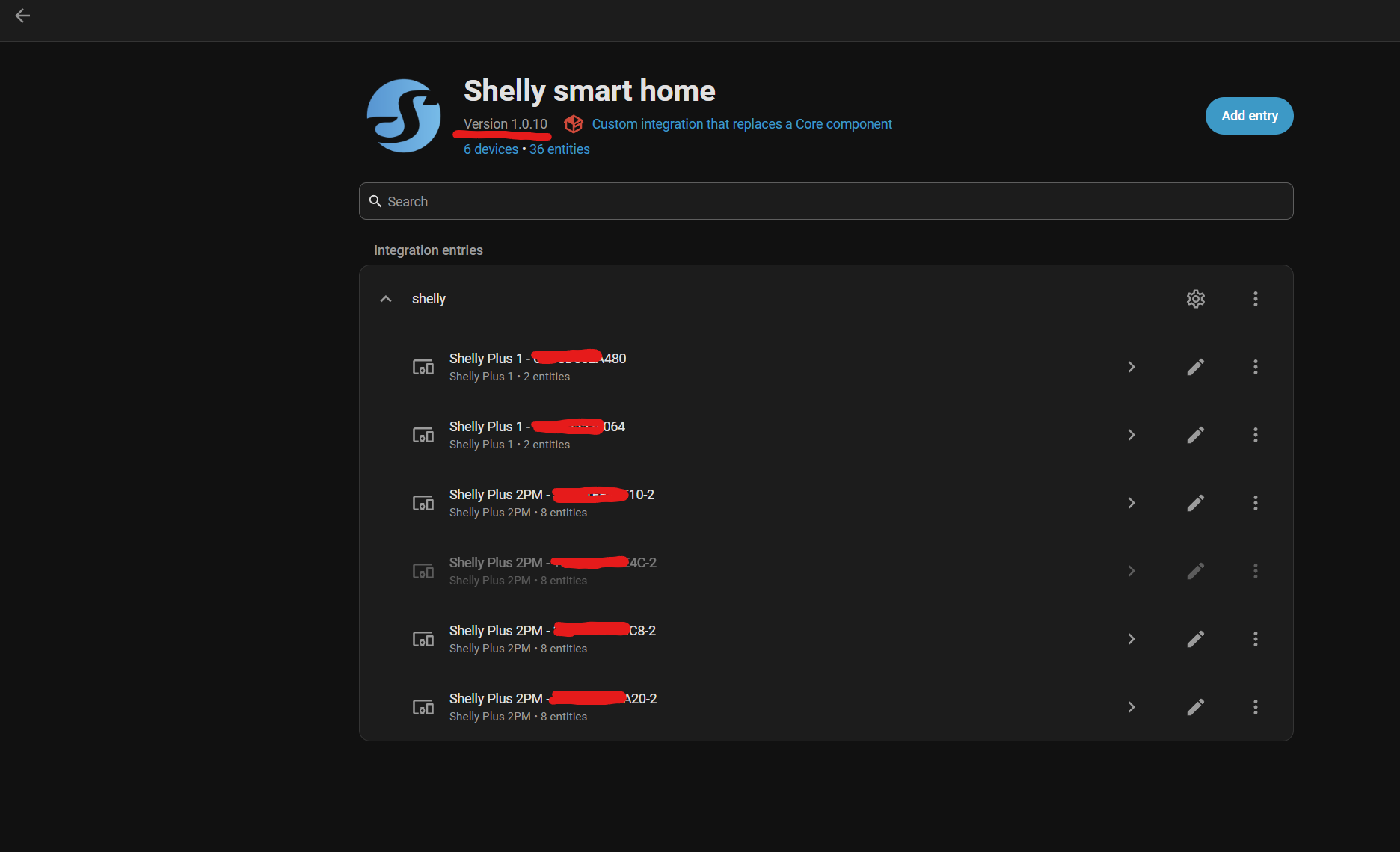

You're using the custom ShellyForHass integration, which hasn't been developed for several years. I encourage you to start using the Shelly core integration Shelly - Home Assistant
Thank you for your prompt response!
Also I am using "Ver 1.0.10" isn't this what you are refereeing to?
Should I delete the "ShellyForHass!"?

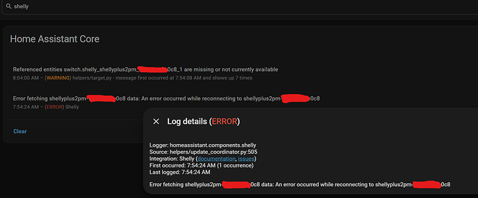

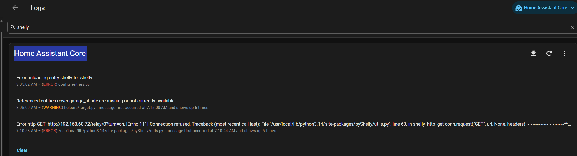

Here are some logs for your reference:
Error unloading entry shelly for shelly
8:05:02 AM - (ERROR) config_entries.py
Referenced entities cover.garage_shade are missing or not currently available
8:05:00 AM - (WARNING) helpers/target.py - message first occurred at 7:15:00 AM and shows up 6 times
Error http GET: http://192.168.68.72/relay/0?turn=on, [Errno 111] Connection refused, Traceback (most recent call last): File "/usr/local/lib/python3.14/site-packages/pyShelly/utils.py", line 63, in shelly_http_get conn.request("GET", url, None, headers) ~~
No issues found for search term 'shelly'
  File "/config/custom_components/shelly/config_flow.py", line 69, in async_get_options_flow
    return ShellyOptionsFlowHandler(config_entry)
  File "/config/custom_components/shelly/config_flow.py", line 76, in __init__
AttributeError: property 'config_entry' of 'ShellyOptionsFlowHandler' object has no setter
2026-06-07 08:05:00.007 WARNING (MainThread) [homeassistant.helpers.service] Referenced entities switch.shelly_shellyplus1_***80 are missing or not currently available
2026-06-07 08:05:02.243 INFO (MainThread) [custom_components.shelly] Shutting down Shelly
2026-06-07 08:05:02.243 ERROR (MainThread) [homeassistant.config_entries] Error unloading entry shelly for shelly
  File "/config/custom_components/shelly/__init__.py", line 120, in async_unload_entry
  File "/config/custom_components/shelly/__init__.py", line 424, in stop

  1. You need to remove all Shelly devices from HA (remove their config entries), remove shelly folder from /config/custom_components, restart HA and configure all Shelly devices once again with HA.
  2. No

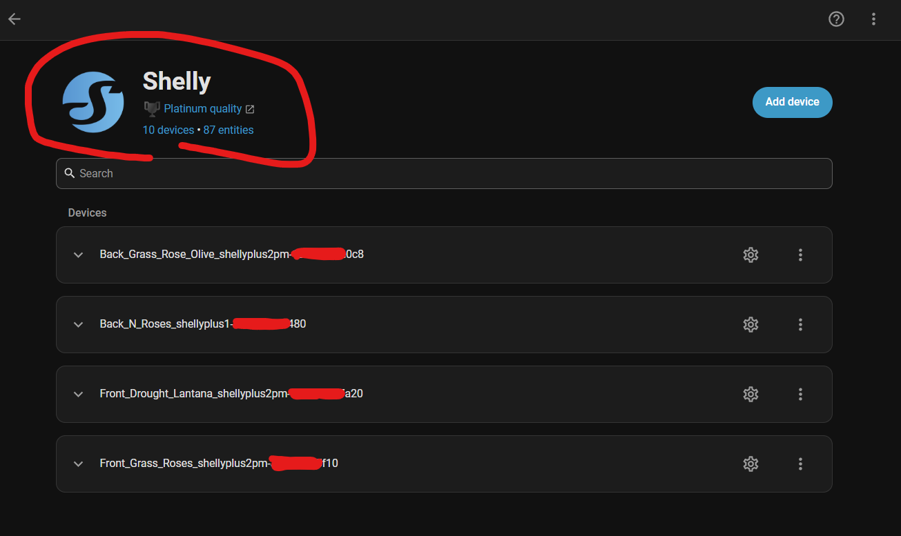

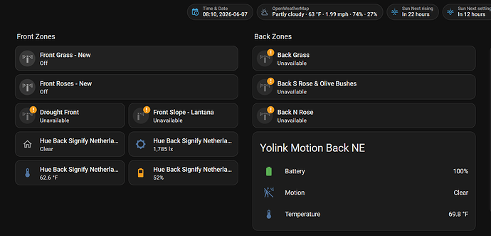

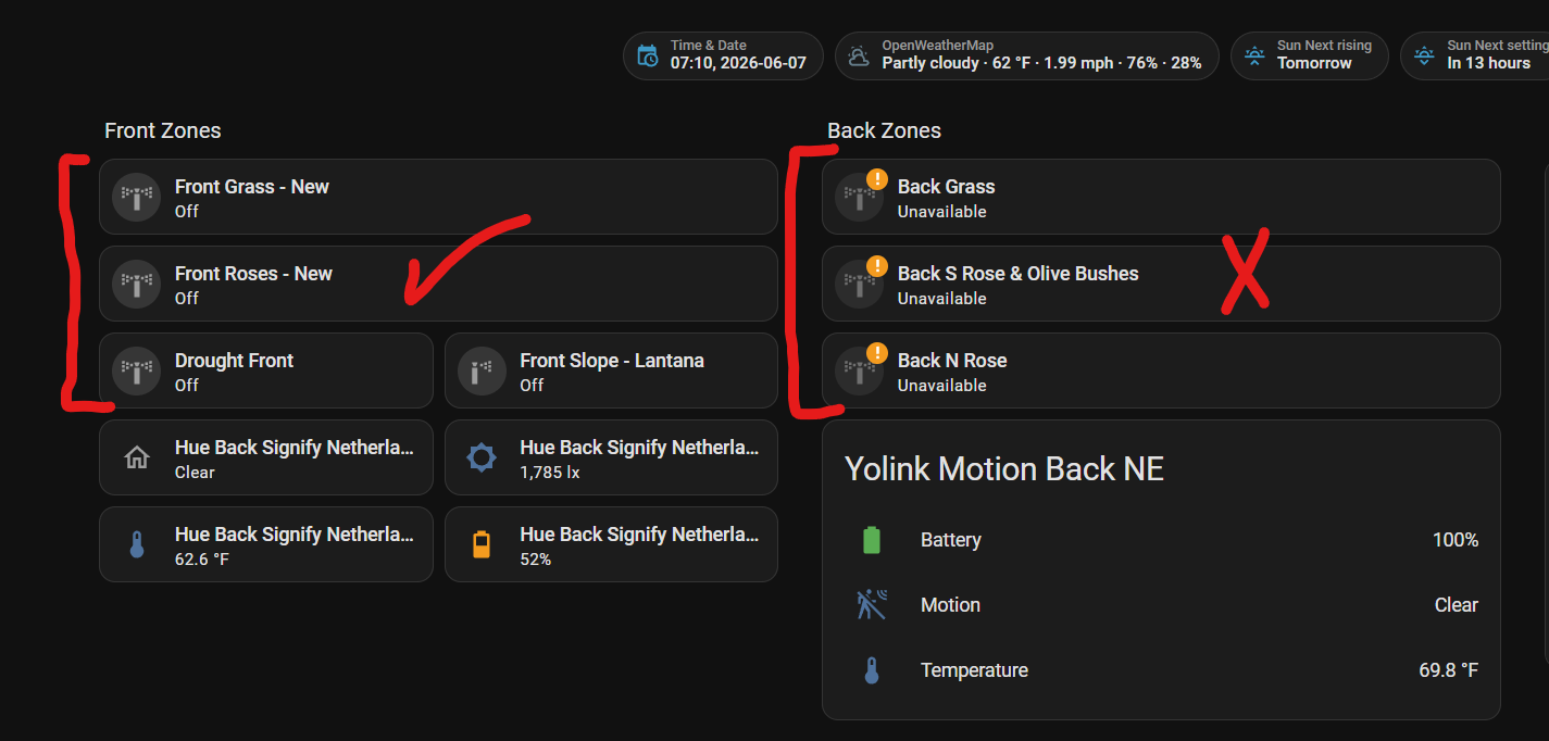

  1. I removed "ShellyForHass!",
  2. removed "shelly" folder and it's content from "/config/custom_components" & restarted HA,
  3. after a while all Shelly Switches started to appear in HA,
  4. added all of them as you see below,

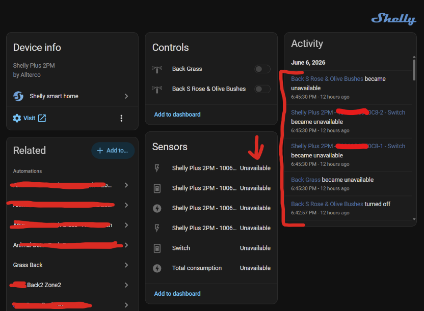

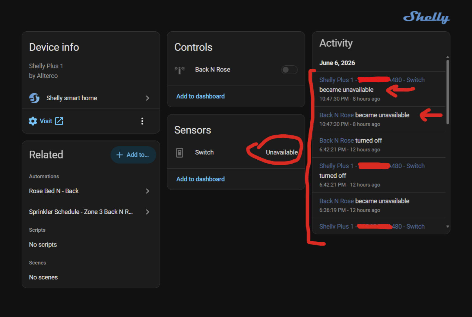

  5. Even though they are all functional in the Shelly iOS app, as you see some are still not available in HA!
This is definitely intermittent. I have to wait and see, if the other switches become unavailable.
Any guidance?

Tiny fragment of log you posted indicates communication issues between the HA server and the devices. Other devices work, so we can assume the problem is Wi-Fi range.
The problem was not the WiFi range, It was a couple of IP conflicts! I narrowed it down to which duplicate IPs where on the LAN, and that fix the problem.
