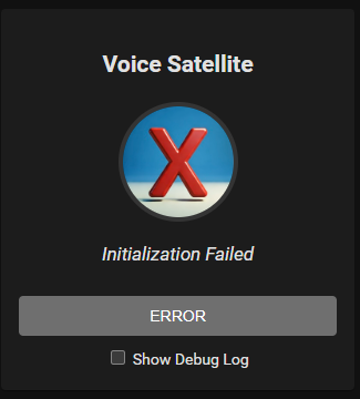

Hey there! Excited to try this but getting this:
Have followed all steps, refreshed browser (shift F5), connecting via HTTPS. Can you tell me what I might need to check?

Run inspect in your browser and watch the console messages. It seems like it’s not loading the modules. Did you put all the project content in config/www/voice-satellite-card?

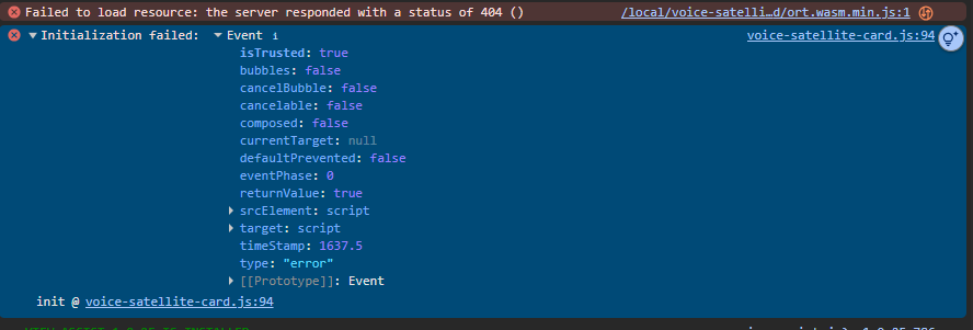

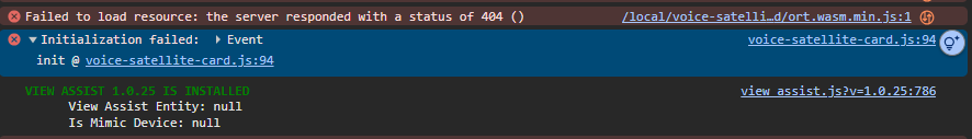

Additional information:

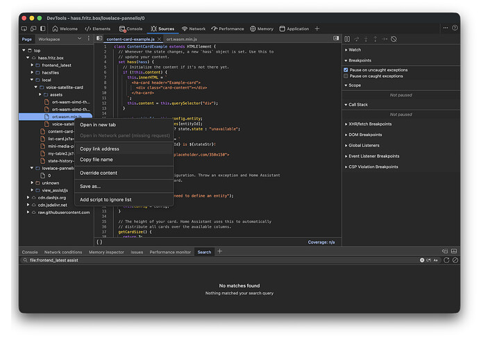

/local/voice-satelli.d/ort.wasm.min.js:1
This is the problem!
Why /local/voice-satelli.d ? Its wrong.
status of 404() = wasn is not loaded
Settings → Dashboards → Resources → Add Resource
  • URL: /local/voice-satellite-card/voice-satellite-card.js
  • Type: JavaScript Module
https://hass.fritz.box/local/voice-satellite-card/ort.wasm.min.js
Check with your browser if the URL (with your address) is accessible.
You should upload the file and view the js code.

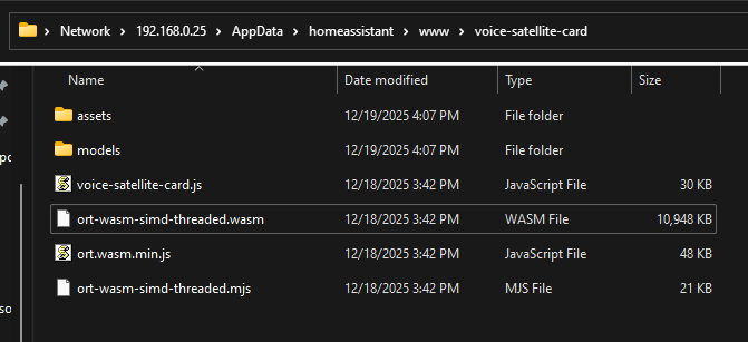

Right. That’s what I have already:
and here’s my config files:
dinki@casaos:/DATA/AppData/homeassistant$ find www/voice-satellite-card/
www/voice-satellite-card/ort.wasm.min.js
www/voice-satellite-card/ort-wasm-simd-threaded.wasm
www/voice-satellite-card/ort-wasm-simd-threaded.mjs
www/voice-satellite-card/assets
www/voice-satellite-card/assets/error.jpg
www/voice-satellite-card/assets/recording.jpg
www/voice-satellite-card/assets/idle.jpg
www/voice-satellite-card/assets/beep-2.wav
www/voice-satellite-card/assets/.DS_Store
www/voice-satellite-card/assets/speaking.jpg
www/voice-satellite-card/assets/listening.jpg
www/voice-satellite-card/assets/beep-1.wav
www/voice-satellite-card/assets/processing.jpg
www/voice-satellite-card/voice-satellite-card.js
www/voice-satellite-card/models
www/voice-satellite-card/models/melspectrogram.onnx
www/voice-satellite-card/models/nexoos.onnx
www/voice-satellite-card/models/alexa_v0.1.tflite
www/voice-satellite-card/models/embedding_model.onnx
www/voice-satellite-card/models/nexoos.tflite
www/voice-satellite-card/models/alexa_v0.1.onnx
www/voice-satellite-card/models/silero_vad.onnx
www/voice-satellite-card/models/hey_jarvis_v0.1.onnx
www/voice-satellite-card/models/ok_nabu.onnx
www/voice-satellite-card/models/hey_jarvis_v0.1.tflite
www/voice-satellite-card/models/.DS_Store
www/voice-satellite-card/models/ok_nabu.tflite
www/voice-satellite-card/models/hey_rhasspy_v0.1.tflite
www/voice-satellite-card/models/hey_rhasspy_v0.1.onnx
What am I missing?

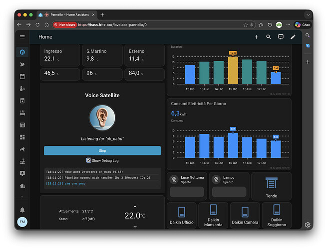

Sorry for the bother. It is working fine on my Chromebook. Not sure why PC is giving problems. Thanks again!
EDIT Perhaps this is because I was not prompted for access to the microphone. I used the Assist button (top right) and then granted mic permissions and then I went back to the voice sat card and it had loaded. I cannot say for certain if I need to do that on PC will try it again when I go back to that room.

I tested with Edge in Ubuntu, Mac OS, and Android (tablet and smartphone).
