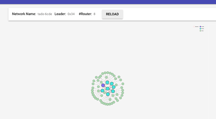

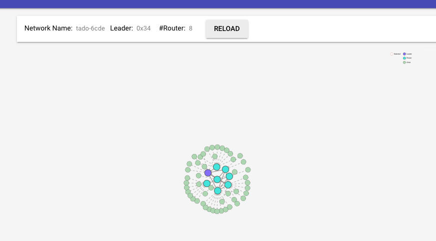

I’m experimenting with HA, since Matter supports multiple ecosystems concurrently. My HA installation includes a “Sonoff Zigbee 3.0 USB Dongle Plus V2” running as an Open Thread Border Router (OTBR). Here are three screenshots to set the stage:

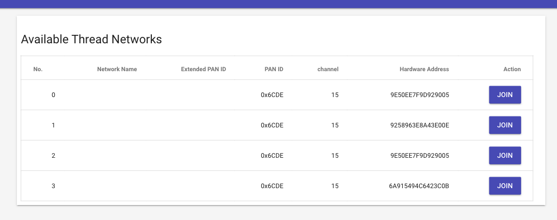

Question 1: Why does OTBR offer me four opportunities to “join” the existing thread network (last screenshot)? It is already part of it, as can be seen from the first and second screenshots.
Question 2: The OTBR topology map (first screenshot) does not provide labels for any of the nodes. Is there a way to configure things so that the 3 x TBR, the 8 x routers (Eve Energy) and the endpoints (Eve Thermo and Eve Thermo Control) are labeled in that topology diagram? Note that I have not yet added most of the endpoints to HA, but I have added a number of the routers, which are named.

Re Question 1, I’m not sure. I checked the Join tab of my OTBR, and I see (up to) six options — five are presumably my Apple TBRs (edit: see below, I confirmed these are Apple devices) and one is something I completely don’t recognize: on a different channel and unknown PAN ID. Could be a neighbor’s Apple TV for all I know. Sometimes I only see fewer options, indicating the scanner is timing out before it sees everything. I suspect this is just showing all the Thread devices (TBRs or otherwise) broadcasting within range during a network scan. I wonder if you run it enough times you will see all your (routing?) nodes.
Re Question 2, I suspect the answer is no. You can click a node to see additional details but unfortunately “name” does not appear to be one of them (edit: ExtAddress can be used to painstakingly determine nodes, see below). It appears to be a feature request opened just a few months ago.
Edited to add: the Hardware Address (ExtAddress in the topology) can be found in the _meshcop._udp.local mDNS announcement under the xa field. For example, the Discovery app on MacOS shows xa={length = 8, bytes = 0xHWADDRESS}

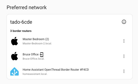

What I should have said is, these appear to be the only TBR that the Apple Home hub is aware of. I don’t have the impression that it is making use of the OTBR/radio on the HA server. Is that wrong?
I have approximately 10 Thread hardware repeaters in the house, set up so that any of the three TBR (including the OTBR) has a path to any of the other devices.
Indeed, when I pulled out the power on the two Apple TBR, there was a period of about an hour, during which the Thread network did self-repair, and went from non-functional to working correctly.
So, the experiment was a success. After about an hour of down time, I was able to see and control all of the devices purely with the HA hub operating via the attached OTBR/radio. The Apple Home hubs were powered down.
The HomePods do serve as the Matter hubs for Apple home, and from what I can tell, the Apple home Matter hub is unable to use any other TBR other than an Apple branded one.
I’m quite happy with this experiment, I was at first disappointed when I switched off the two Apple HomePods and the HA dashboard blanked out. But then it gradually repopulated as the Thread network rebuilt itself.
