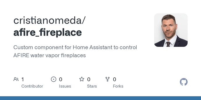

I had some time to dedicate to reverse engineer the mobile app and was able to create a custom integration with all the functionalities available in the mobile app and through the remote controller. It requires internet connection as it uses the cloud API but in the future I am planning to extend the functionalities with local LAN control. Feedback and contribution to the project are always welcome.
