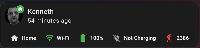

Could someone help me figure out what the problem is with this code please, I copied it from another user but, for me, I can’t get the wi-fi/cell etc to show correctly nor the charging status icons. Despite quite a few states using colour and different icons I just get this:
I’m fairly sure it’s a simple error and possibly something silly I am missing but, for the life of me I can’t work out what.
And the code I have is as follows:

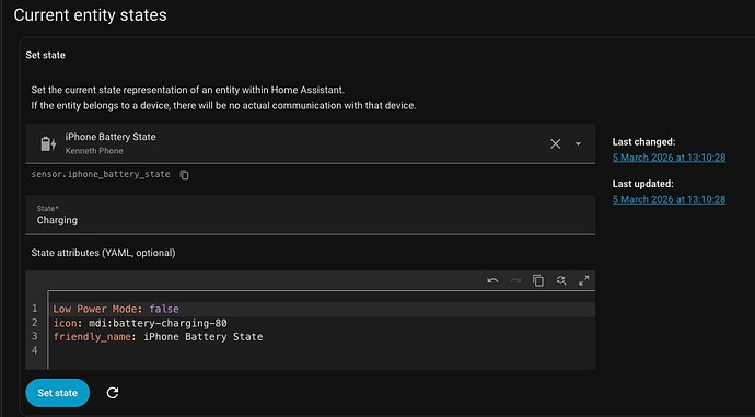

You might not be sharing the sensor values in your companion app.
Check the values of your sensors in the developer tools.

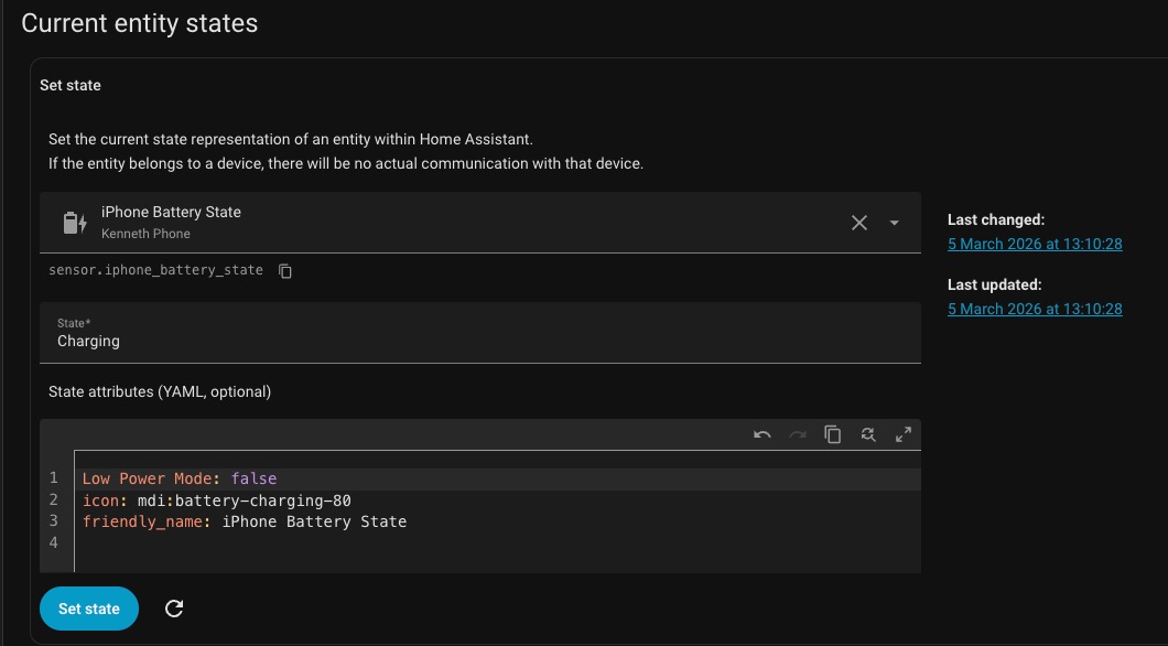

Thanks but they all appear to be shared okay and the change is seen, as shown here:
2026-03-05_13-10-40
But the icon doesn’t update as I would expect that it should.
What does the developer tools say?
Do you mean this:
Battery_state == Charging , Is Not ‘on’ ( Unless you’ve found the “State == on” some where else ? )
Same goes for your other “Entities” … always check them in /Settings/Dev-Tools-#States, so you know what’s right , i.e device_tracker is Never “Away”, It’s “not_home”
I think the state is no longer wifi, but instead, wi-fi. Add the hyphen, that’s what I had to do.
@boheme61 is correct. The example you show is using a binary_sensor to check the state, but iOS doesn’t include that by default. Your options are to create a binary_sensor helper to provide the on/off logic, or even more simple, just use the included sensor and change the state from “on” to “Charging”
Thank you.
I was out for a bit so managed to check that it does change to cellular just fine from and back to Wi Fi no problem. Just the icon and colour/s don’t change from what is shown above.
Same with charing and, I tried changing from “on” to “charging” which works just fine, no issues other than again the icon/colour doesn’t update as I would expect.
I just can’t seem to work out why given that what’s reported is correct and, if you click on the chip the info is all good, the sensor is fine and the status is shown correctly there.
Your screenshot says Charging and not charging.
Also be sure to correct it in all places.

Thanks that last bit of code you gave solved the connection one, that now displays 100% correctly! :smiley:

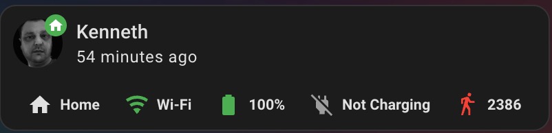

The status shows different on different images as I was trying to show that it is updating, HAss knows what the state is just something in the code to change what’s shown seems to not be working.
Charging now working as well, brilliant, thanks you. :smiley:

Just to let you know and others, that worked great, ends up looking like this for me:
It’s a lot of info in a very small space that can be taken in with little more than a glance, which I like.
