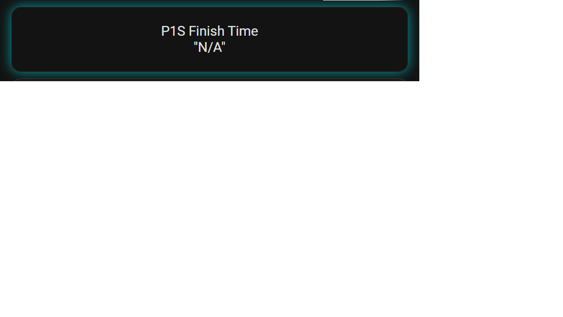

thanks so much, that was it, really appreciate your help!
just as a follow-up, when the printer is not in use, it says “N/A”. is there any way to get rid of that?
