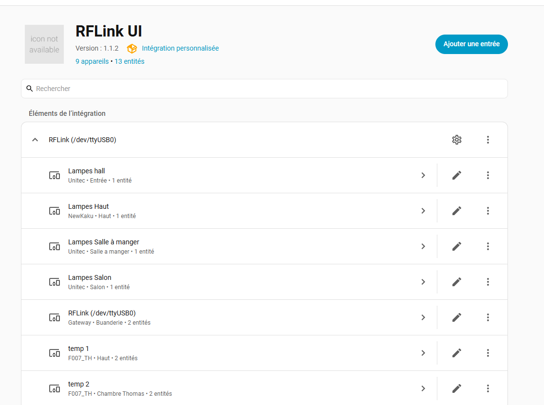

Since switching the RFLink UI configuring is a lot more easy. I love it to bits. Stability is great.
With the CC1101 added to ESPhome and setting up a proxy is there a way to utilize that in RFLink UI? Would be great to replace my trusty but old RFLink Arduino with something modern. Maybe I am missing some points here and it's more of a wish than a possibility. Thanks
Nice! Works great so far. I have 2 RFLink units (one for 433 and one for 866MHz), RFLink-UI can handle both, unlike the original RFLink integration.

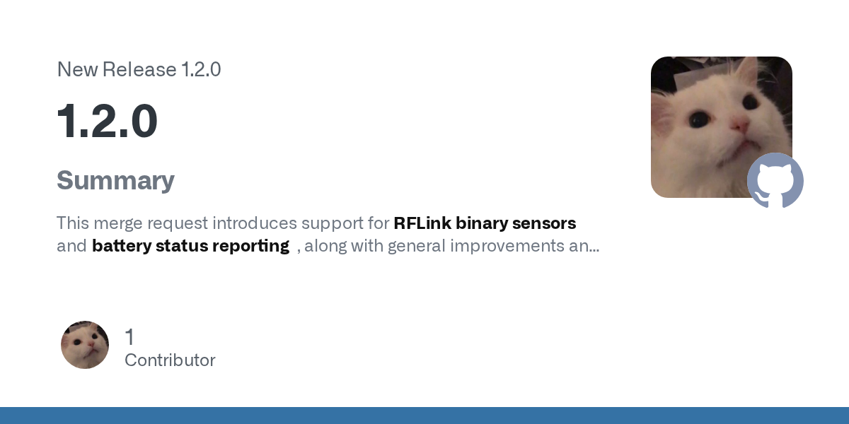

I just retested the RFlink UI after you added other platforms like binary_sensor.
It’s working great. I’m using it temporarily alongside the legacy RFlink YAML config (not advised, I know), and there appears to be no conflict.
