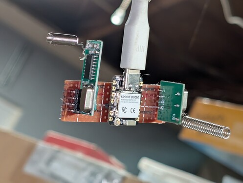

What IP address is your MQTT broker on? Is it a static IP? Your ESP01s doesn’t seem to be connecting to it from what the logs say.
Eh? It’s on a static IP.
INFO Connected to MQTT broker!
I don’t know what’s going on there, but the dump you posted indicates you are trying to receive IR, not 433.
I was wondering about that. How do I tell it that I’m sending RF? And Ya, everything is coming out as pronto, which I am not yet familiar with. With other systems (SDR, dumb outlet receiver and various software tools), I’m only able to identify the timings, not the actual protocol being used. It seems like the protocol is something different than what either Tasmota or ESPHome know about.
From what I’ve read so far, maybe it doesn’t matter? The differences between IR and RF are minimal. Just a different frequency, and a few different data bits at the start and end of the transmission is all I have identified for differences between the two.
I don’t follow you at all.
And I don’t remember all the passes you have done here.
What hardware setup you have at the moment?

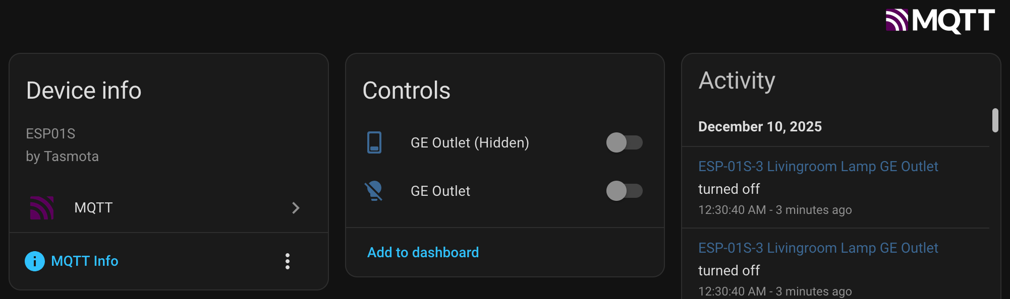

Configure MQTT in Tasmota.
Set up a MQTT-based switch in HA. Note the command template.
mqtt:
  switch:
    - name: "GE Outlet"
      state_topic: "stat/tasmota_C6F471/POWER"
      command_topic: "cmnd/tasmota_C6F471/RFSend"
      command_template: '{"Data":"{{ "0x14" if value == "ON" else "0x12" }}","Bits":24,"Protocol":1,"Repeat":4,"Pulse":211}'
      unique_id: sensor.ge_outlet
      retain: true
      device:
        manufacturer: "Tasmota"
        identifiers: "tasmota_C6F471"
        model: "ESP01S"
Use the UI to create a Light from a Switch. I could have created a Light instead of a Switch within MQTT. But a Light doesn’t support command_template, which is critical to sending the right on/off payloads to MQTT.
When I press the transmitter button, its payload is received by the ESP. If the payload matches the data in Rule1, it’s resent out to the MCU. If that changes the state of the outlet, the relay pin reflects the state like a switch, and the HA state is updated to show it.
When I turn the light on and off in HA, HA publishes to MQTT RFSend {<payload>} (same as the payload from the transmitter). This gets “sent” out the RFSend pin in Tasmota, to the MCU and the MCU changes the relay.

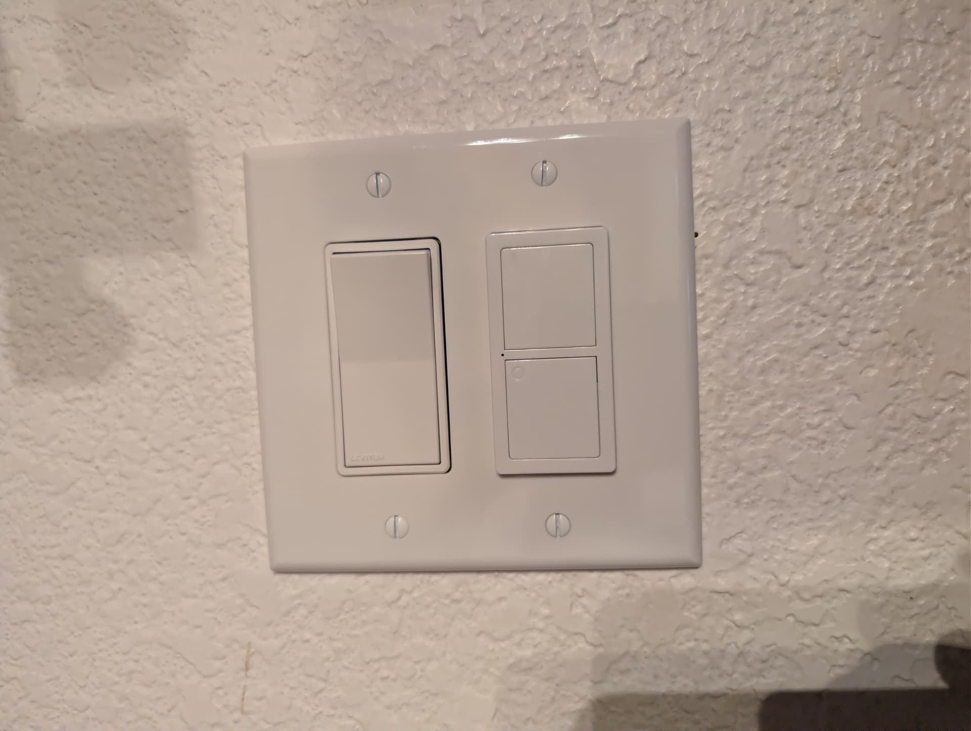

  • The wireless buttons look nice and fit within a standard “Decora” switch plate, and I can get more buttons and pair them as needed.

Mini-project that spun off of this thread: A cheap 433MHz bridge.
ESP32-C6 board (so I can add BT relay later)
433MHz ASK/OOK transmitter and receiver
Some prototyping board
This hangs from the rafters in my garage and relays the 433MHz buttons I use as light switches to MQTT, which triggers an automation that turns on the smart outlets controlling the garage lights. It replaced an RTL-SDR solution. Improved reliability and response time from 1-2sec to “before your finger leaves the button”.
A pic of the remote installed nicely into the wall plate. The switch on the left is real and has a box behind it. The switch on the right is the remote for the GE outlet, and is just stuck to the wall. The screws don’t go into anything.
