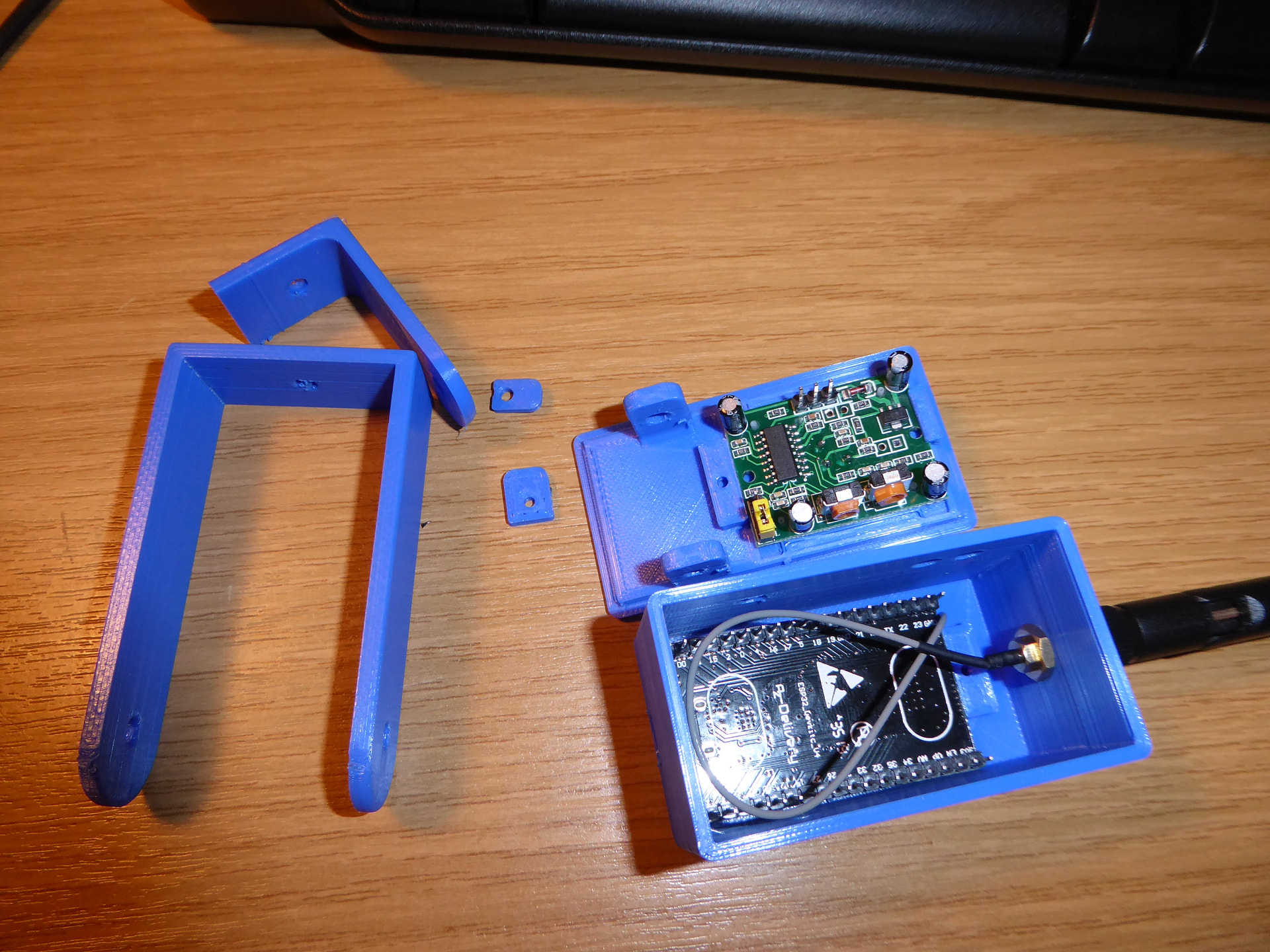

I have created a few years ago Autodesk Fusion design for 3D-printer. Two versions, another for ESP32-Wroom-32U with external antenna (as in the picture) and another for ESP32-Wroom-32D with internal antenna. Use and modify freely.
