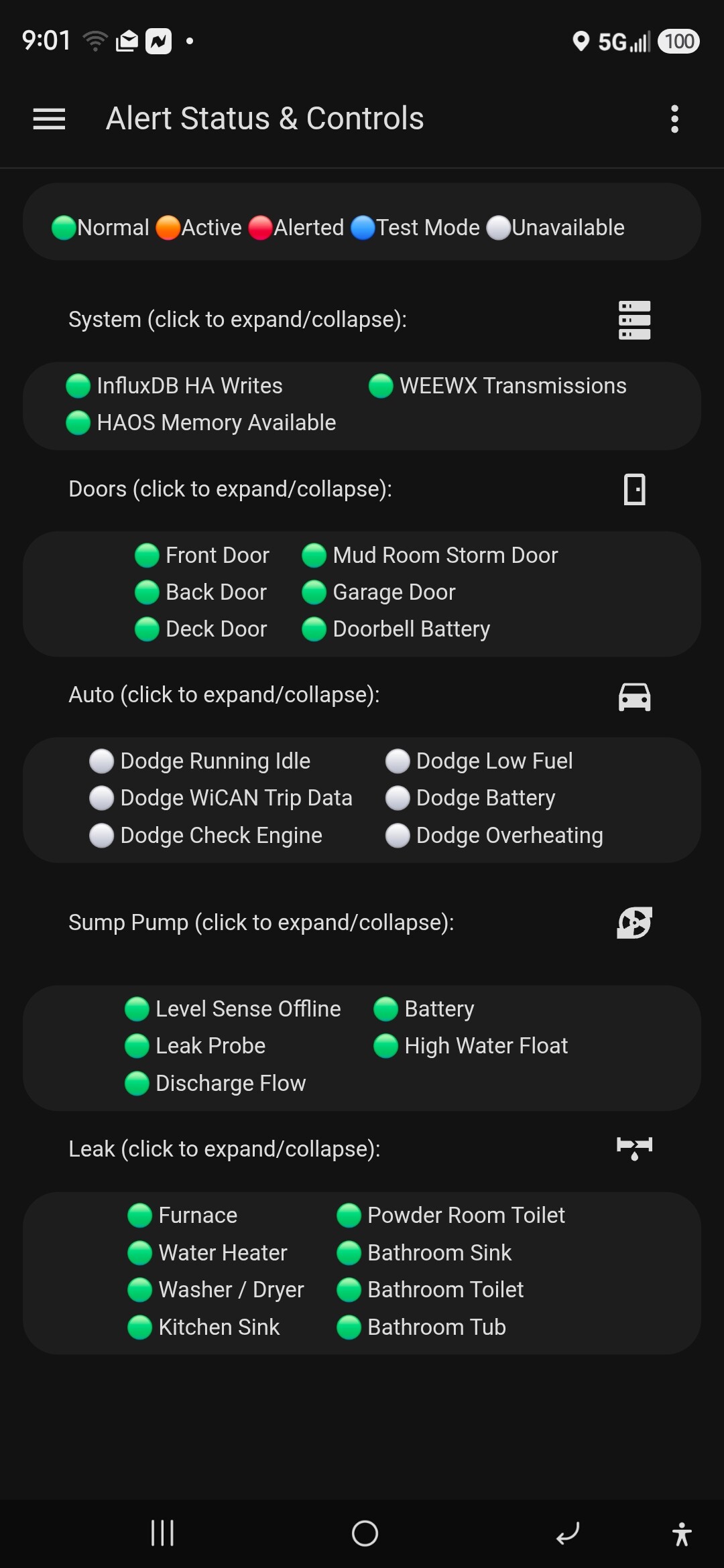

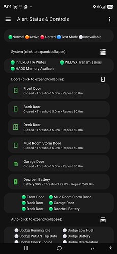

I wanted bulletproof alerts originally when I created by “Noonlight Enhanced” integration for my alarm system, so I did have them working very well and decided to extend that into a framework. Funnily enough the alarm has to be so bulletproof that I did not want a separate dedicated controls dashboard for the alarm system as there are many other parameters there to include other than just the alerts. Balow I am showing the end result dashboard I use for controlling my alert framework.

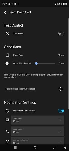

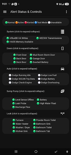

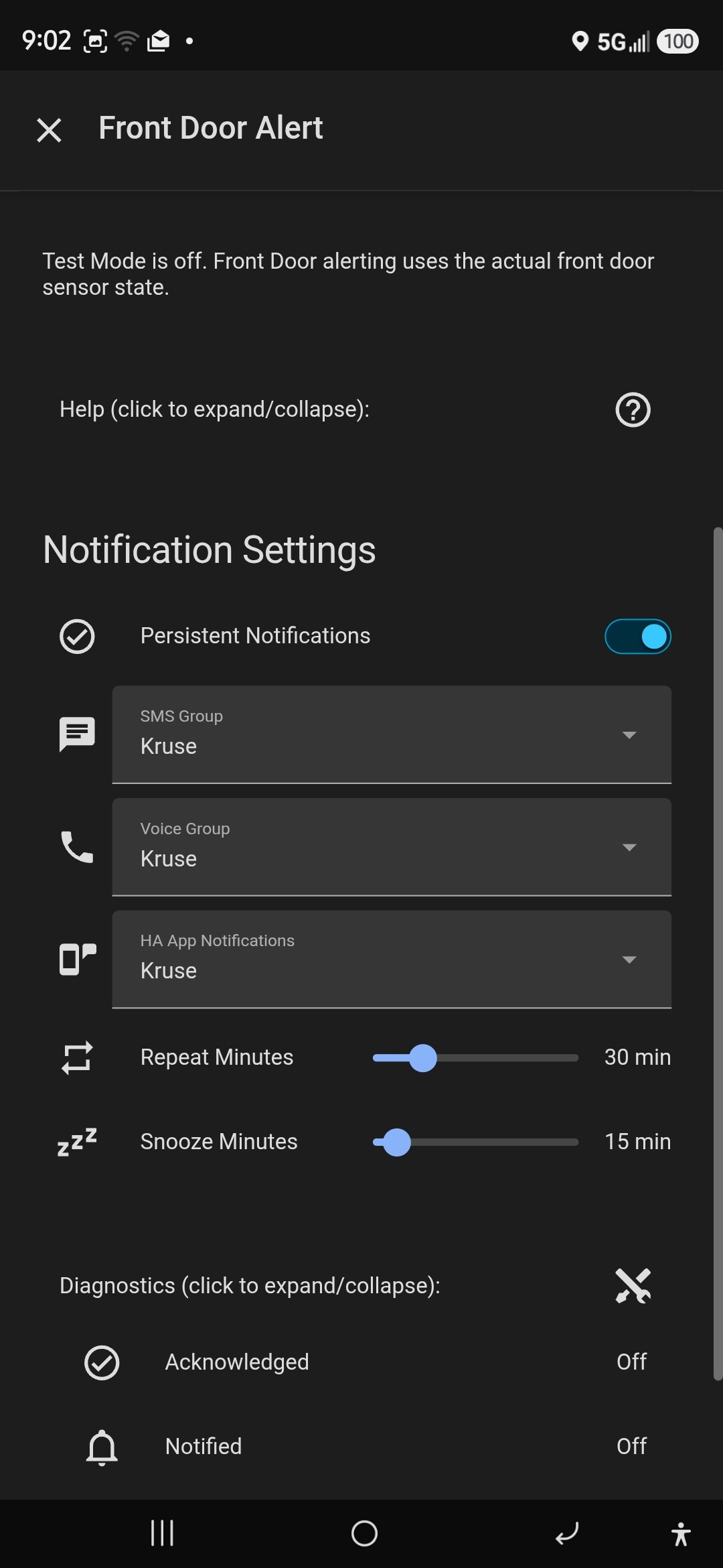

I ran into so very many settings I ended up creating an Alert Controls Dashboard which I show here (front door example):

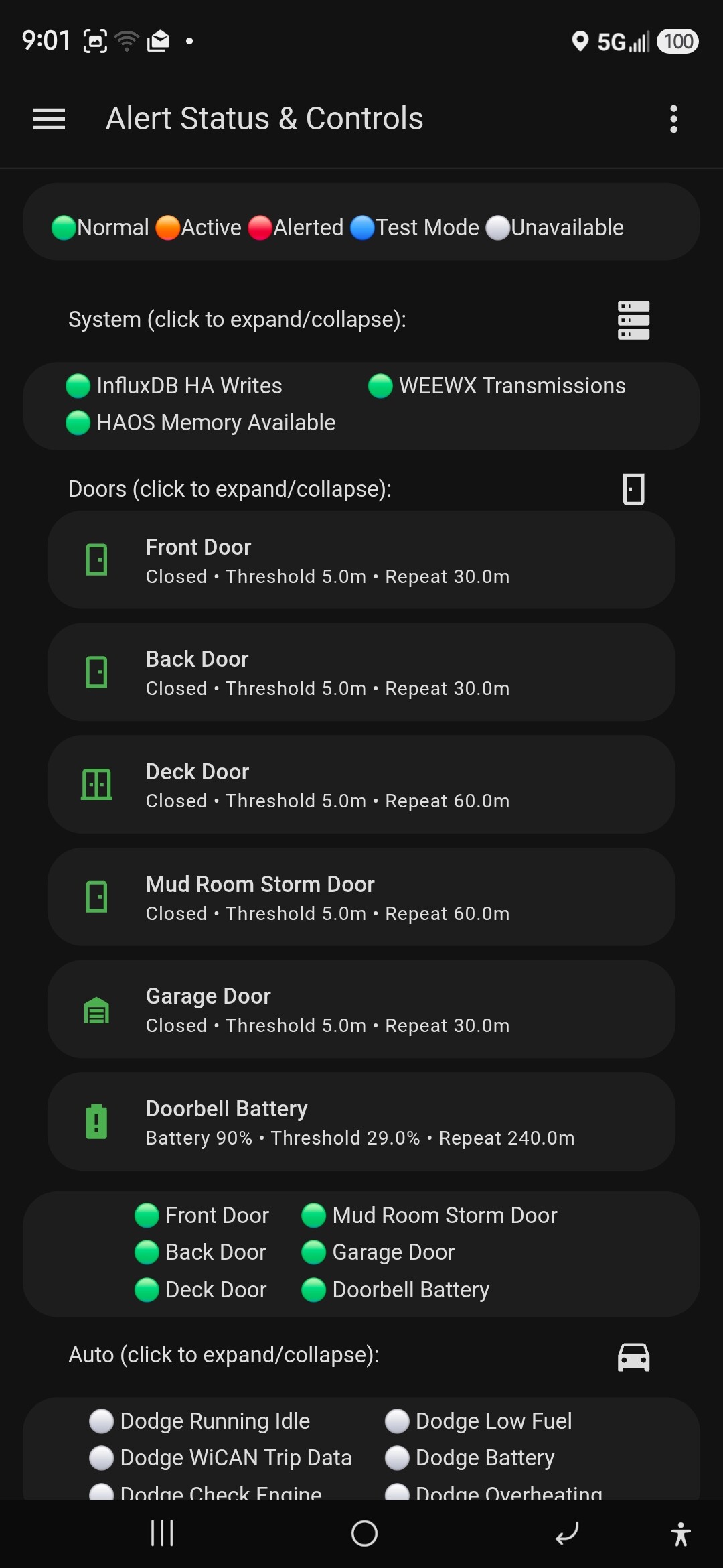

And for example when you click on the expansion for the door section:

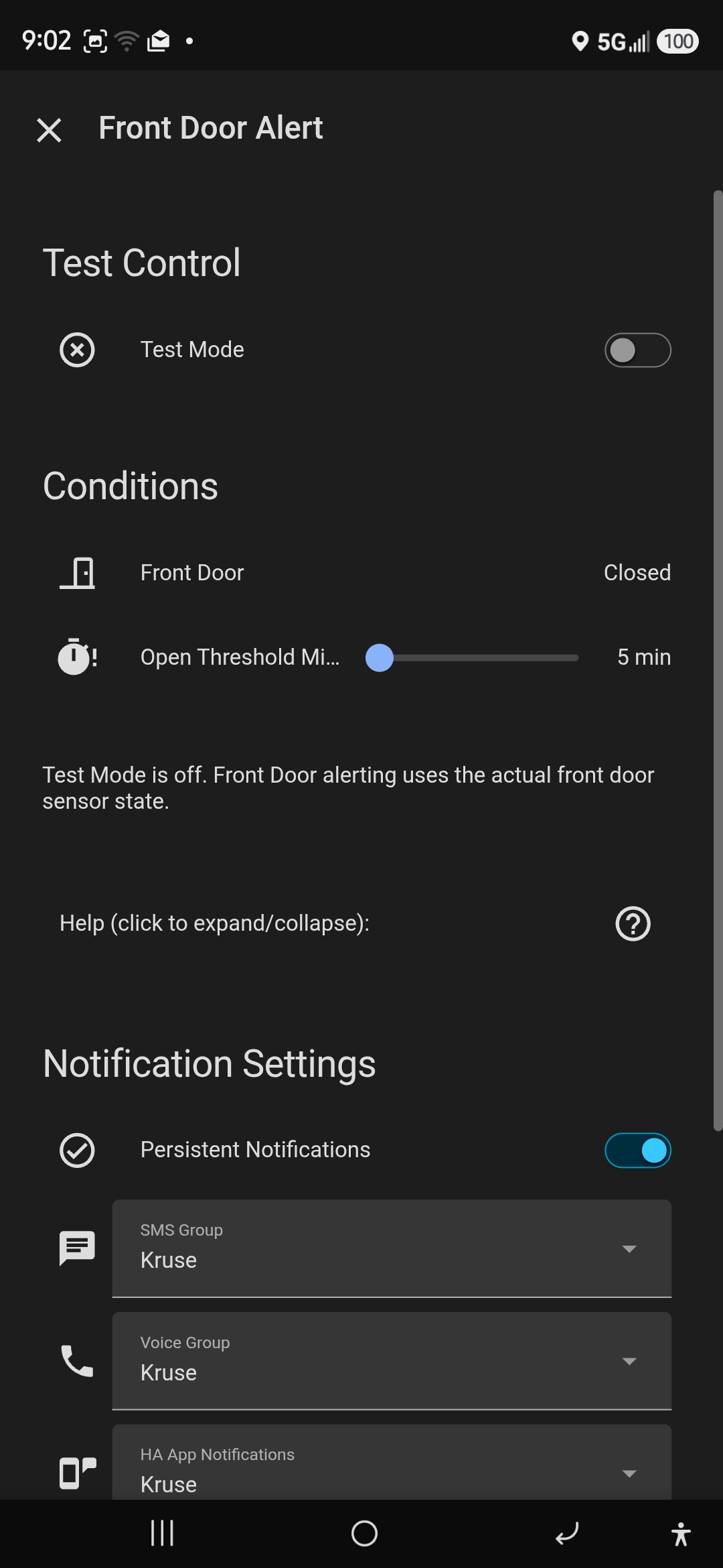

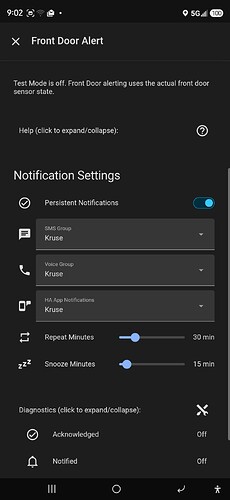

So then you got example go into the front door card (fiurst one there in the group):slight_smile:

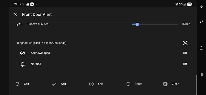

The Help section there is also an expandable section - and it is too large to see all the details so I’ve scrolled down and clicked on the disagnostics rollup section:
Actually that picture isn’t showing the bottom of that screen either - so
