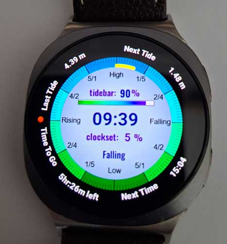

Plan B was to use a range value as a circular bar and this is what I eventually ended up with.
The Yellow line increases around the circle instead of a pointer
The addition of the tidebar was done by adding another % into the mix which is the difference between the two tides using another range value as a bar
Here is another version with just the tidebar, which is great if you want to just glance at your watch for the info as you are sailing. I have to use my local VPN to access the data from my phone to get to Home Assistant when not on the local network, but that's OK
Although this seemed to be surprisingly difficult, I am pleased I stuck at it, because I now have a very usable tool out on the water.
