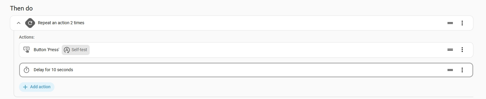

For example, you can repeat the self-test several times with a delay between each run:
repeat:
  count: 3
  sequence:
    - action: button.press
        entity_id: button.smoke_alarm_self_test
    - delay: "00:00:10"
This can be useful if you want to turn your Matter smoke alarm into a remotely triggered buzzer for simple notifications or testing, especially if you don’t want to purchase a separate smart siren. Of course, this only uses the Self-test function — the actual fire alarm pattern remains reserved for genuine smoke detection.
You can of course adjust the repeat count and delay to suit your own needs.
