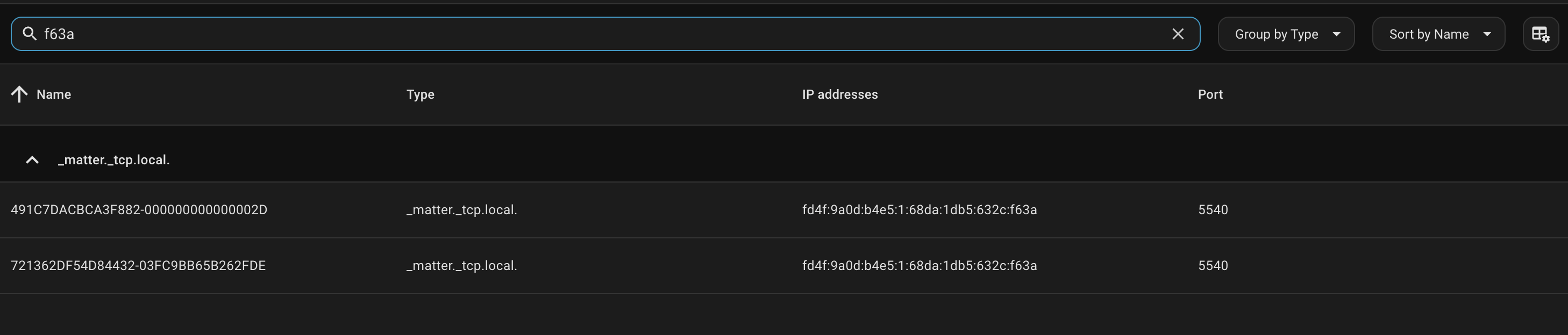

Helpful, thanks! What I really want is a single view that shows me the name of the device next to it’s IP. Zeroconf shows me this:
In this example, the zeroconf browser suggests 2 devices have the same IP. Is there a view or dashboard I can set up that merges the data? Then I could figure out why.

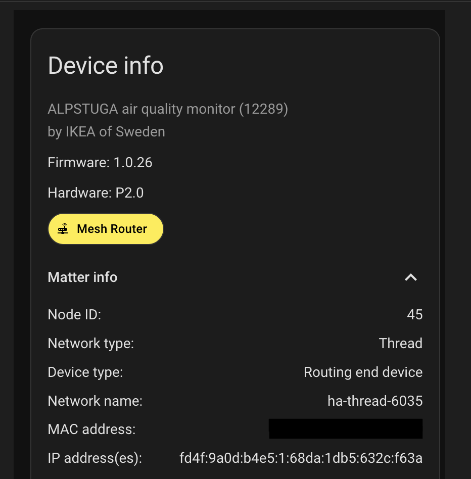

What? But it is in the software. If I can see this on one page:
and this in another page:
then I know that’s the same device. What’s to stop a script from putting the name of the device (“ALPSTUGA air quality monitor (12289)”) next to the IP in a list?
I mean, it literally exists on each device page, I just don’t want to have to open 100 devices one by one to find the IP my log is yelling about.
