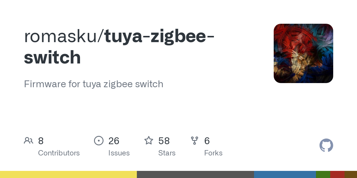

There’a custom firmware for tuya switches that enables binding and others
Might wanna look into that
Thanks, I put a star on this project as I may use it in the future.
Sadly, mine are dimmer modules, not switches. So my module is not listed here.
Do you think that I will need a custom firmware to support bindings tough?
