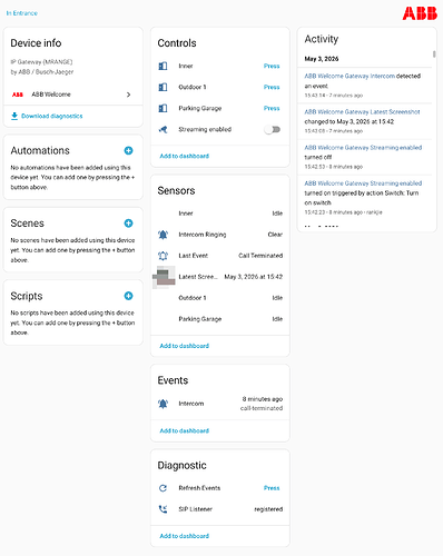

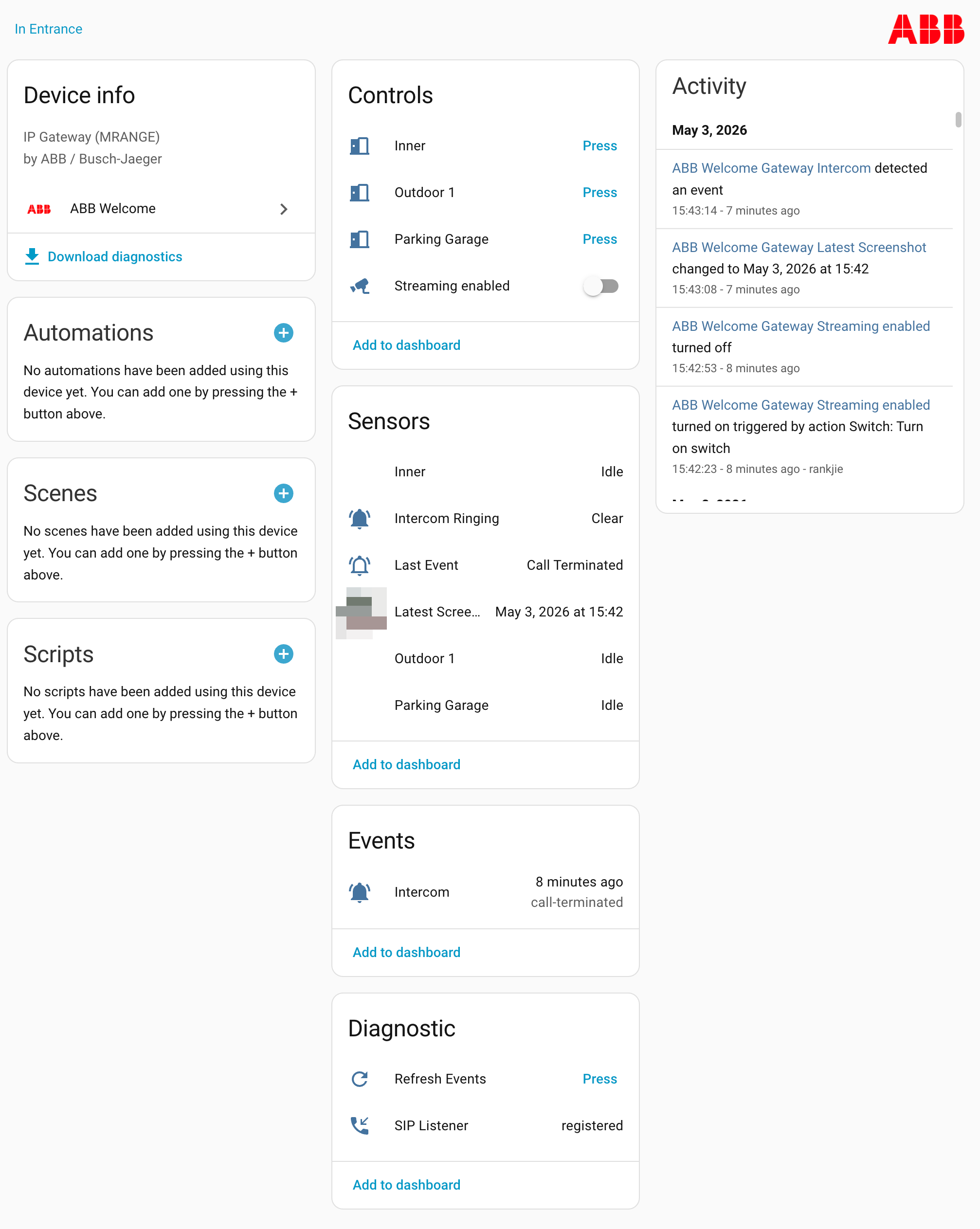

  • Button per outdoor station (Outdoor 1 / Inner / Parking, etc.) for unlocks.

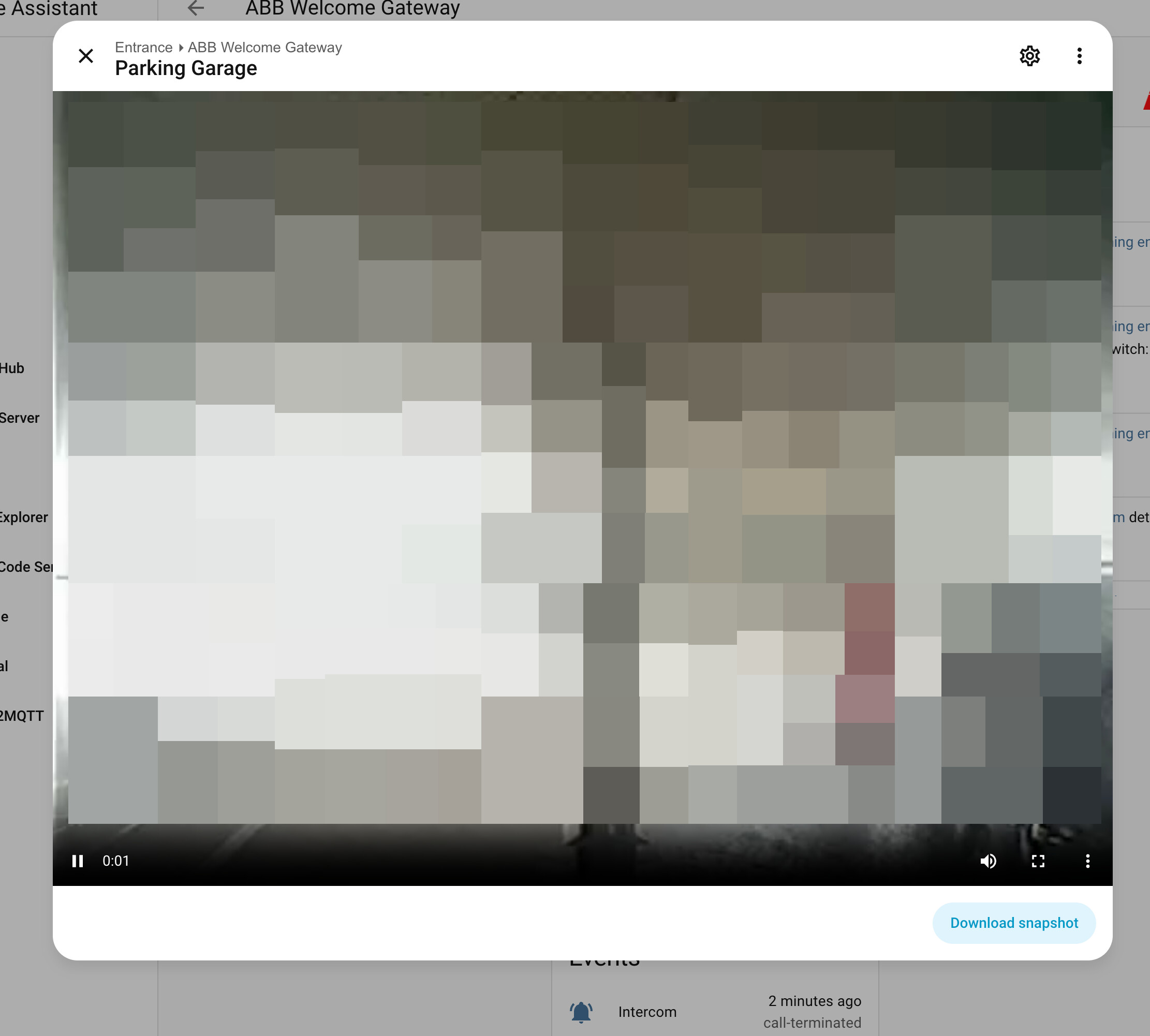

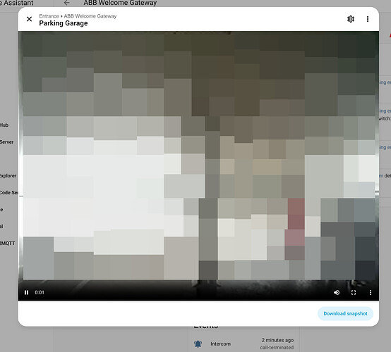

  • WebRTC camera entities for each discovered outdoor station (H.264 video + PCMA/G.711 audio via go2rtc).
  • Realtime ring binary_sensor + abb_welcome_ring event bus — passive SIP listener, fires within tens of ms of someone pressing the doorbell. Doesn’t interfere with indoor stations or the official ABB app.

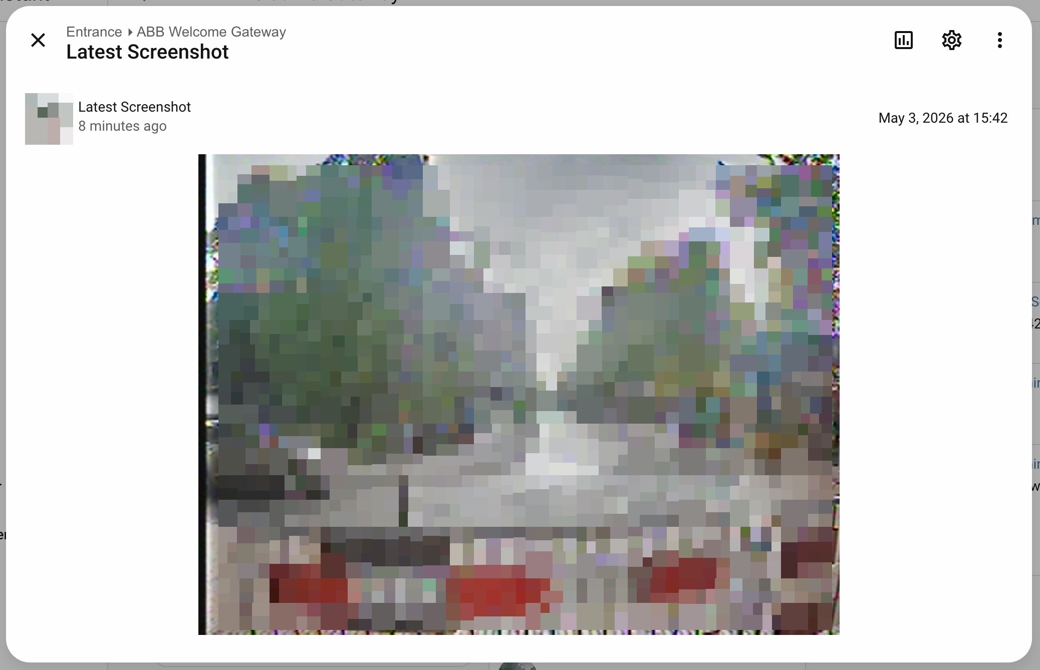

  • Image entity with the latest doorbell screenshot (timestamp reflects actual ring time).
  • Event entity + last-event sensor for ring / call / door-open history.
  • Switchable unlock strategy (Hybrid / Fast / Standard SIP flows) for gateway compatibility.
Live camera stream from outdoor station

  • Live streaming is gated behind a streaming_enabled switch because the building intercom media session is exclusive; you don’t want HomeKit/frontend prefetches accidentally holding it open.
