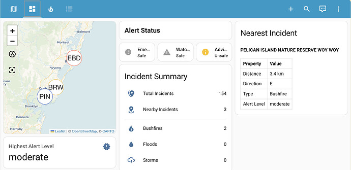

Hi Troy - many thanks for this integration. It’s very much appreciated.
As this post isn’t a bug or request, I thought it made more sense to post here rather than Github.
I’m new to building Dashboards and really wanted a map that would show up conditionally when something was occurring in my watch region. I have your integration installed, but it only seems to provide buttons.
I couldn’t see anything in your documentation regarding dashboards. Apologies if there is. If not, could you provide some information or advice?

@Festy let me know if this is what you were looking for homeassistant-abcemergency/examples at main · troykelly/homeassistant-abcemergency · GitHub
I’ve added a couple of examples there.
