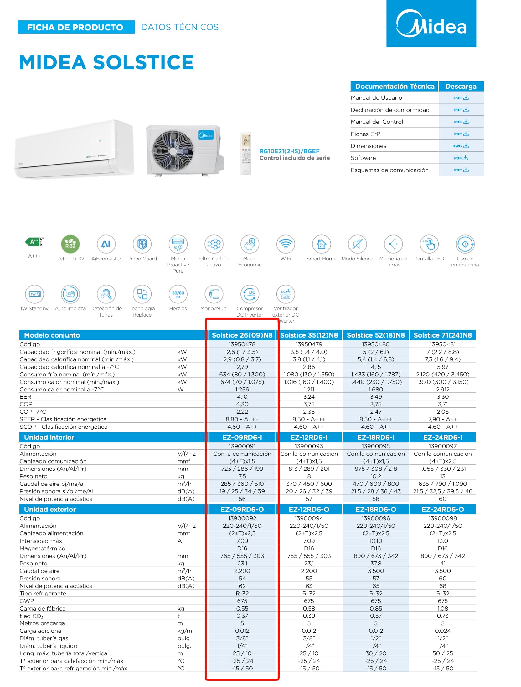

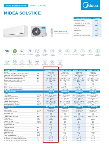

Does anybody knows how compatible is this unit Midea Solstice 26(09)N8 with HA locally? I need 5 units and I’m considering options

That’s what I want to know. I’ve checked on the forum and I can’t find this unit listed. Is there any way to make sure it works?
Thanks @ShadowFist , I can’t find this model. How can I know if I can use this unit with the ESP32 dongle?

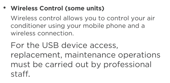

Had a look at the manual & it mentions a USB device for wifi, which means that it should have a USB port.
If you’re going to buy 5, I’m sure the supplier will be happy to confirm whether it has a USB port for you before purchase.

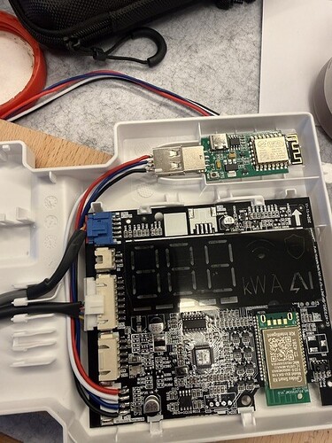

Sorry to raise an old thread but I'm also looking to get a Midea Solstice AC and was wondering if anyone determined if the SWLF01-Pro / ESP32 worked in them for enabling local control? I'm reading that the newer Midea ACs no longer have a USB port so wanted to confirm
It is not working! The Solstice has a build in Wifi Modul and no plug for the USB Wifi, but you can soldered to the Board.
I have soldered the SLWF-01Pro, but it make no connection.
