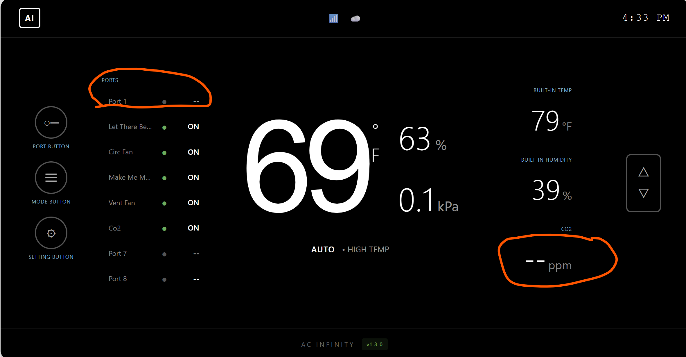

I am pretty new to Home Assistant, but I’m making some great progress! I loaded the AC Infinity AI_ integration and dashboard, and I noticed a wrong entity type for CO2. It is set as a binary sensor when it should be a sensor (with the correct entity name). Sadly, I am not experienced enough to know where to find and edit. I am also seeing that port 1 is not being picked up like the others.
Any suggestions and/or guidance is appreciated!!
Just click in the box you have circled and select the correct entity. It will start with sensor.bat_farm... instead of binary_sensor.
