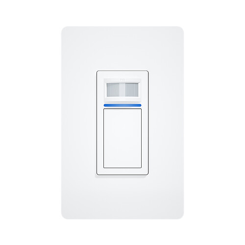

I’m not clear what form factor you are looking for, but I have a number of these wall switches that report both a binary sensor for motion and have a relay (switch) controlling the output (lights). All over WiFi, with open source Tasmota firmware:
