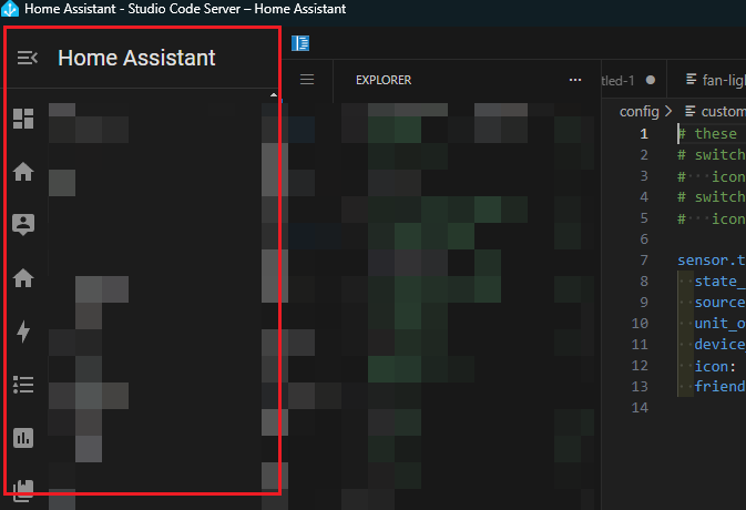

Currently accessing the VSCode add-on in a HA iframe, but it affects my shortcut keys. Is there a way to access the HA VSCode directly without the iframe, aka without seeing the red box?

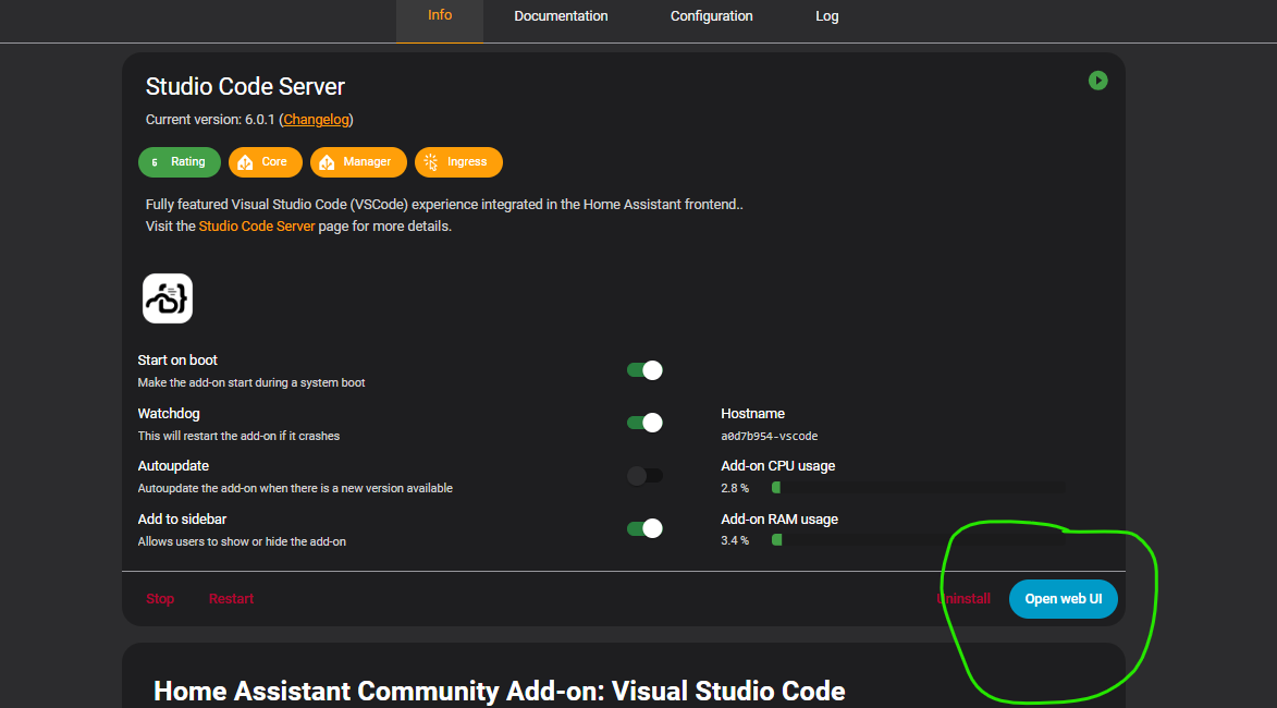

Look at the URL your get when you hit this button:
I think some JS handles that button, there is no URL when I hover over it. Even if there was (like the one we find in the sidebar), it is the URL that opens VSCode in an iframe

No, I can recognize that as the URL that loads in an iframe. The one that loads without iframe has .../api/... in it
For me I can load that in a new window

For everyone who doesn’t understand what he wants and still decided to tell him what to do:
He wants to load the webinterface of the addon directly. Not he HA webinterface containing it as iFrame. Because the keyboard shortcuts are catched by the HA webinterface itself I guess.

I acknowledge that iframe was not mentioned initially, I did not have the words for it then, and was quickly correctly thereafter. But I did have the red box right at the start to indicate what I did not want to see. My apologies and thanks again.
Well, as my screenshot above proves, your initial question was different (as pointed out by Pieter), so I’d appreciate you not trying to make me look stupid when in fact it was your poorly worded initial question, plus subsequent change to the topic. I do know what an iFrame is.
