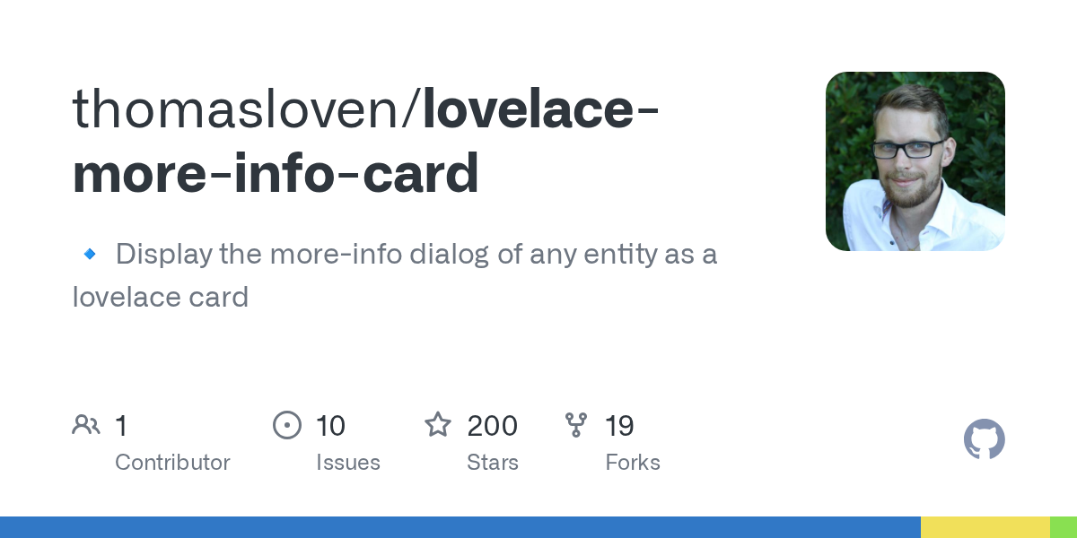

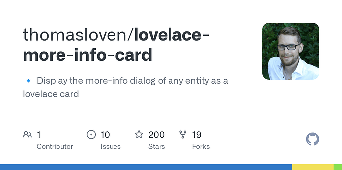

There’s a “more-info-card” in HACS, but I don’t know if it will work from a badge.
That doesn’t look like it’s going to do what I want. From the looks of it, it just make the more-info pop-up available as a lovelace card which isn’t what I want. I want the details popup that is on the triple-dot menu of the more-info card.
